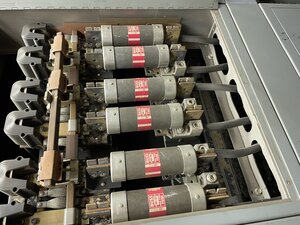

I have a old FPE switchboard that has two fuses per phase. In the attached image you have 300-amp fuses with 300 MCM cable. I am assuming for proper results in SKM this would need to be modeled as a 600-amp fuse with parallel 300 MCM. Any thoughts or suggestions on modeling this?

Thanks bbaumer, I suppose I should have asked my question with more detail. I am really concerned more with the TCC as I have a 300-amp breaker in the panel downstream of the 300-amp fuses. We really have a 600-amp feed to the panel. I can make the drawing look like the picture, but with a 300-amp fuse the TCC does not tell the story.

Is this your facility or a customer's?
If it's yours, and you only have a 300 amp rated panel downstream, remove one set of fuses and disconnect the corresponding set of conductors at the panel.
Or
Replace the fuses with 150's, although I think removing one set of fuses would be more appropriate.

I just re-read your last post. Is the 300 amp breaker in the downstream panel a main?
The panel itself would be protected from overload by the main in that case.
MLO panel the 300-amp is a feeder out of the panel.

Questions and Answers:
1. Why are there five conductors on the load side of the fuses.
2. The Buss NOS, is only a 10kA fuse, these should be changed. Best choice would be a Mersen A6D or Buss LPS.
3. A 400A fuse clip will accept fuses in the range of 225-400A.
4. In your case the ampacity rating of the parallel fuses would be .85 X 600 or 510 amps- this accounts for proximity heating and sharing.
5.This part is a stretch. since the NEC does not allow (in general) parallel fuses, it is hard to define the parallel ampacity rating. However, if I use the normal UL/NEC rules, your parallel rating would be .8 X 510 or 408 amps. Note 1: the UL test does not allow a UL98 rated switch to be loaded more than 80%. Note 2 - this method should keep the fuse terminals at or under 167F when loaded to 408 amps.
6.This means the wire ampacity must equal or exceed 408 amps.

I see 6 conductors on the load side.
