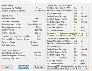

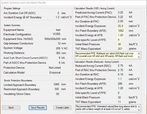

Ommi
Post subject: Re: Quantity of carbonized particles before Arc Flash Initia Posted: Wed Apr 03, 2019 7:32 pm |
Joined: Wed Feb 20, 2019 3:06 am Posts: 45
Ommi wrote: After exhaustively exploring the derivations of the f and M formula and comparing it with complex numbers addition with different transformer setups. I came to the conclusion the difference is only less than 7%. In my exact setup with the 3 phase open delta transformers 20 feet from the service panel. Isc (transformer Isc) = 6971A Using f and M method (with 20 feet of awg 1): 5913A Using complex numbers addition of each component (with 20 feet of awg 1): 6248A. They are close. The f and M results are a bit lower. Just 5% difference. This is even when the transformers and voltage were increased up to Isc of 50,000A. The reason I'm knit picking on them is because of IEEE-1584 2018 in which anything above 2000A can arc flash. And it's true. I can now confirm that at 6000A, it can arc flash when the panel was not empty (that is when it has breakers). Remember the IEEE-1584 2002 tests assume empty panel (what were they thinking?) Now my two last questions before I move on from all these. 1. What are the arc flash standards used in say Europe or China or Russia? Do they all follow the IEEE 1584? In the US. arc flash at low voltage incidents are so low. Of course because it is 120 volts. But elsewhere where it is 240v. How is the arc flash incident statistics? 2. Until now I still haven't used my arc flash PPE. And remember it's only to open and close breakers for this panel:  With arc flash incident energy only critical at the arms part for 6000A maximum short circuit current and since the opening above is only very small. It's justified only arc flash jacket is required. Therefore I plan to cut my Oberon PPE suit so I can use it for example as cool jacket in malls or wear it elsewhere.  How best to cut it. Or better yet. since it's inherently flame resistant. I don't think more washing can damage it anyway. Because if I won't cut it. Then it will be used only once in say 3 years or so when the panel above needs to be turned off or repaired. And with only 6000A maximum short circuit current. I don't think the slags can reach the legs part with such small panel opening, isn't it. On second thought. I won't cut it anymore. Last night before I slept. I tried a free software that can only register up to 208v. I hope the creator of this web site can create one too. I entered 2 secs and the incident energy at 305mm away is 25.9cal/cm2 and arch flash boundary is 1.662 meters (1.2cal/cm2). It horrified me (see attachment). Also I read "Investigation of Factors Affecting the Sustainability of Arcs Below 250 V Michael J. Lang, Member, IEEE, and Kenneth Jones, Member, IEEE" "The testing discussed in this paper shows that sustained arcs are possible at 208 V even at relatively low fault currents but are dependent on several factors including voltage variations, conductor material, the configuration of conductors, and the presence of insulating barriers. The challenge to industry is to advance the research identified in the references, do additional testing on a variety of low-voltage equipment, and incorporate those findings into improved standards. These test strategies must consider all practical locations within the equipment where arcs may occur; within all equipment is the possibility for different electrode orientations." And I read "Effect of Insulating Barriers in Arc Flash Testing Robert Wilkins, Member, IEEE, Mike Lang, Member, IEEE, and Malcolm Allison, Member, IEEE " "With an insulating barrier arc lengths and voltages are lower, the arcing currents are higher, and the maximum energy density, which is found on the middle calorimeter, is much higher than the one measured with the standard IEEE 1584 setup. Self sustaining arcs can also be produced at 208 V with relatively low levels of bolted-fault current." I hope IEEE can create experiment where the 208v 6kA 12mm gap can be sustained for 10 secs. I want to see if it would equal the incident energy of major high voltage switchgear meters away. Whatever, I guess I need to get Oberon ballistic PPE suit. Our PPE is only based on thermal and not adequate.
| Attachments: |
