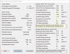

PaulEngr, and others,
Something puzzles me regarding differences of bolted short circuit current between two calculation methods.
Given single phase 240/120 transformers with 75kVA rating and 2% impedance
computing using the infinite bus short cut method
75,000/240/0.02=15625 amp
or the long cut (with derivation) method
kVa = 75,000
voltage =240v
The impedance of a load that would draw 75 kVA is 240^2/75000 = 0.768 ohms.
Transformer impedance = 0.02x 0.768 = 0.01536
Short circuit current = 240v/0.01536 = 15625 amp
Now consider 20 feet of wire has resistance of about 0.002 (from an online wire impedance calc)
To add them together one, one uses this
Total impedance = sqrt (0.002^2 + 0.01536^2)= 0.01549 amp.
bolted short circuit current 20 feet away AWG 1 is 240/0.01549= 15494 amp
The difference with adding 20 feet of AWG 1 wire is decrease of only 1% of the short circuit current.
Now consider the Arc Flash fault calculation method below:
http://www.cooperindustries.com/content ... rmulas.pdf
You can try it in excel spreadsheet at https://electrical-engineering-portal.c ... alculation
Input the same data.
With terminal short circuit current of 15625 amp.
The short circuit current 20 feet away AWG 1 is much lower 11595 amp.
Why is it much lower?
Did the arc flash method somehow give the 20 feet conductor an inductive value, but it's not part of the transformer winding.
Let's go to the Arc Flash Calculation method formulas.
at 1Ø Line-to-Neutral (L-N) Faults
f = [2 x L x I (l-l)] /[ C x n x E (l-)]
Where:
L = length (feet) of conductor to the fault.
C = constant from Table 4 of “C” values for conductors and
Table 5 of “C” values for busway.
n = Number of conductors per phase (adjusts C value for
parallel runs)
I = Available short-circuit current in amperes at beginning
of circuit.
E = Voltage of circuit.
(How did they determine C where the bolted short circuit current is much lower using this method but high when directly computing for it. How did they derive f?).
Then you get M = 1 / (1+f)
And multiply the transformer terminal short circuit current by M.
The result is much lower bolted short circuit current 20 feet away (awg 1) about 25% less compare to the ballpark computations. Why? Where is the hidden impedance in the wire. Instead of 0.002, it becomes higher like 0.010, how?

Is it possible the official arc flash current fault calculation method based on getting the constant c and solving for f and Isc is just wrong?
Maybe Jim Phillips has developed his own formulas different from the faulty official ones?
The short circuit current in the official method at 20 feet away (AWG 1) wire is 25% less while in direct logic based computations, it is only 1%. In fact an electrical engineer not familiar with arc flash calculations told me it was only 1% (he was the one who taught me how to compute manually) and he couldn't understand why the arc flash method becomes 25%.
I'm not asking for detail computations of loads, etc. I just want to know the fault current 20 feet away of service conductor (AWG 1) given any transformer source Isc. For my particular case, I have already computed the Isc of the transformers with help from an EE.
My building is only office load, so no need for motors, and all those miscellaneous equipments available in large commercial settings. Also I live in the Philippines so can't attend Jim classes in the USA as much as I want to.
So my questions are only limited to the previous message why the offical formulas based on getting constant C and solving for f and M and Isc gives too low short circuit current after 20 feet of service conductors.
PhilEngr, any ideas?

Transformer impedance is almost purely inductive and I'm assuming you used the "resistance" column instead of the 60 Hz AC impedance column for the wire impedance? This is where we get into some confusion amongst short circuit models. The simplified methods usually assume that X/R >> 10 so that we can conveniently essentially ignore R and do all the calculations based on X.
A further issue is that arcing current is much lower than short circuit current. It is almost an adjustment unto itself relying on short circuit current, system voltage, and arc gap. The IEEE 1584-2002 model is given here:
https://www.ecmag.com/section/systems/a ... it-current
In reality there are a couple things going on. The first one arises from our simplification in assuming that arcing current is RMS when in fact it's not. It extinguishes and restrikes at a finite (nonzero) voltage. At low voltages it looks almost like a square wave whereas at higher voltages this effect almost disappears entirely. Thus the system voltage shows up in the empirical equation. Second for obvious reasons the arc gap has a pronounced (linear) effect on the arcing voltage in that it produces a voltage drop. Third the available fault current wll increase air temperature as it goes up which lowers the threshold arcing voltage which is in turn driving the arcing current (RMS perception).
Aside from this considering the Lee model which is that maximum power transfer occurs at the point where the arcing resistance (assumes arcs are purely resistive) equals the system resistance, which is a purely theoretical argument. So we get Iarc = 0.5*I-short circuit. This value cannot be less than this since maximum power transfer cannot exceed half the short circuit power transfer. With DC arcs it becomes more obvious that there are factors at play that decrease the arcing voltage (equivalently the arc resistance increases) to one of two stable points that are below the maximum power transfer point. This is an underlying effect on the AC arcs as well. You can see it very clearly in the "bimodal distribution" that shows up in IEEE 1584-2002 in the charts and tables. Sorry that this did not show up in the 2018 edition. I haven't seen the chart anywhere outside of the standard so I can't give you a link to what I mean.

OK, here is a link to what I believe to be the NEC table that I usually use, since the values match.
ftp://ftp.conagua.gob.mx/OCPBC/aps/Proy ... 202008.pdf
X-subL is 0.057 ohms per 1,000 feet so j0.000114 ohms for 20 feet; R is 0.16 ohms/1000 feet so for 20 feet we get 0.0032 ohms. In comparison to a transformer impedance of j0.01536 ohms, the reactance is pretty miniscule (1%) but the resistance is around 20% of the transformer impedance...not a lot but not insignificant.
The spreadsheet I believe you are referring to is the one that IEEE distributed on the 1584-2002 CD. You can find it here:
https://www.google.com/url?sa=t&rct=j&q ... -gHD7rym77
The Cooper EPR-1 document referenced in the spreadsheet contains quite a few multipliers to account for errors but it kind of looks like the IEEE 1584 spreadsheet doesn't take these into account. So transformer short circuit is simply (kVA*1000)/(1.732*V-line-line)*(100/%Z) which is pretty much the text book answer for the infinite bus assumption which basically assumes no impedance on the primary side. It also doesn't appear to be accounting for motor contribution which is done for traditional short circuit methods but not done here. In terms of arc flash motor short circuit contribution dies down in a couple cycles anyways so quite often especially in simplified calculations it gets ignored.
Then we get to the "f" and "M" factors you referred to. These in turn depend on a "C" factor. It took a little digging but Cooper reveals what the "C factors" are in another version of the calculation here:
Basically C is equal to 1 over the impedance (Z) of the wire. Values are taken from the standard IEEE Color Books series on performing short circuit calculations. I didn't check very many but it looks about right to me.
The f and thus M factor is visible in a tab of the spreadsheet. I'm not 100% sure on the math of what they are doing but it sure looks like the right formula for calculating short circuit current given an upstream short circuit value (point to point method) and just the cable impedance.

I think you made an error above. 20/1000feet = 0.02 * 0.057 = 0.00114. You wrote "0.000114".
It's not far from the resistance of 0.0032 ohm so the inductive reactance is somewhat significant too.
Computing for Z at 20 feet is sqrt(0.0032^2 + 0.00114^2)= 0.003397 ohm
But let's just focus for now on 1000 feet as I'm verifying the NEC table manually (how it gets the values in the table).
In the NEC list for AWG 1 above, the inductive reactance (Xl) for 1000 feet has value of 0.046 ohm for PVC conduit
See:
1000 feet of awg 1 has calculated inductance of 687000 nH or 0.000687 H see: https://www.allaboutcircuits.com/tools/ ... alculator/
The inductive reactance is 2 pi f L... or 2 (3.141) (60) (0.000687) = 0.259 ohm http://www.66pacific.com/calculators/in ... lator.aspx
Why is the 0.259 ohm so far from the NEC listed value of 0.046 ohm?
How does NEC derive the 0.046ohm? Can you help derive 0.046 ohm? I've been trying it out for hours already.

The IEEE 1584 spreadsheet is just using the simple FLA, f and M formula. The values entered was the same in other spreadsheest and one can easily compute it by hand. For example, the bottom matches the IEEE 1584 spreadsheet because they use the same formula:
The following spreadsheet is more intuitive as the formulas are written on the page:
So it boils down to how the formula f = 1.732 * L * I / N * C * E(l-n) and M = 1/ (1+1f) is derived. I need to know this because I'd like to know if the formula integrate already the following arc flash dynamics, such as arc flash added impedance, heating up lowering threshold voltage, arc gap causing voltage drop, etc. or is the above formula independent of these??
If they are already integrated. How did they do it?

On second thought. I won't cut it anymore. Last night before I slept. I tried a free software that can only register up to 208v. I hope the creator of this web site can create one too. I entered 2 secs and the incident energy at 305mm away is 25.9cal/cm2 and arch flash boundary is 1.662 meters (1.2cal/cm2). It horrified me (see attachment).
Also I read "Investigation of Factors Affecting the Sustainability of Arcs Below 250 V
Michael J. Lang, Member, IEEE, and Kenneth Jones, Member, IEEE"
"The testing discussed in this paper shows that sustained arcs are possible at 208 V even at relatively low fault currents but are dependent on several factors including voltage variations, conductor material, the configuration of conductors, and the presence of insulating barriers. The challenge to industry is to advance the research identified in the references, do additional testing on a variety of low-voltage equipment, and incorporate those findings into improved standards. These test strategies must consider all practical locations within the equipment where arcs may occur; within all equipment is the possibility for different electrode orientations."
And I read "Effect of Insulating Barriers in Arc Flash Testing Robert Wilkins, Member, IEEE, Mike Lang, Member, IEEE, and Malcolm Allison, Member, IEEE "
"With an insulating barrier arc lengths and voltages are lower, the arcing currents are higher, and the maximum energy density, which is found on the middle calorimeter, is much higher than the one measured with the standard IEEE 1584 setup. Self sustaining arcs can also be produced at 208 V with relatively low levels of bolted-fault current."
I hope IEEE can create experiment where the 208v 6kA 12mm gap can be sustained for 10 secs. I want to see if it would equal the incident energy of major high voltage switchgear meters away.
Whatever, I guess I need to get Oberon ballistic PPE suit. Our PPE is only based on thermal and not adequate.
