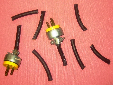

This was used in a hotel where we were presenting our seminars.
After we complained to the manager she cut this up into these pieces. :roll: The NEC does cover this calling it a hazard. Find that rule and add it here call by its Section number please. We should always say Section and not Article when citing a NEC rule.
File comment: Cut them up!
