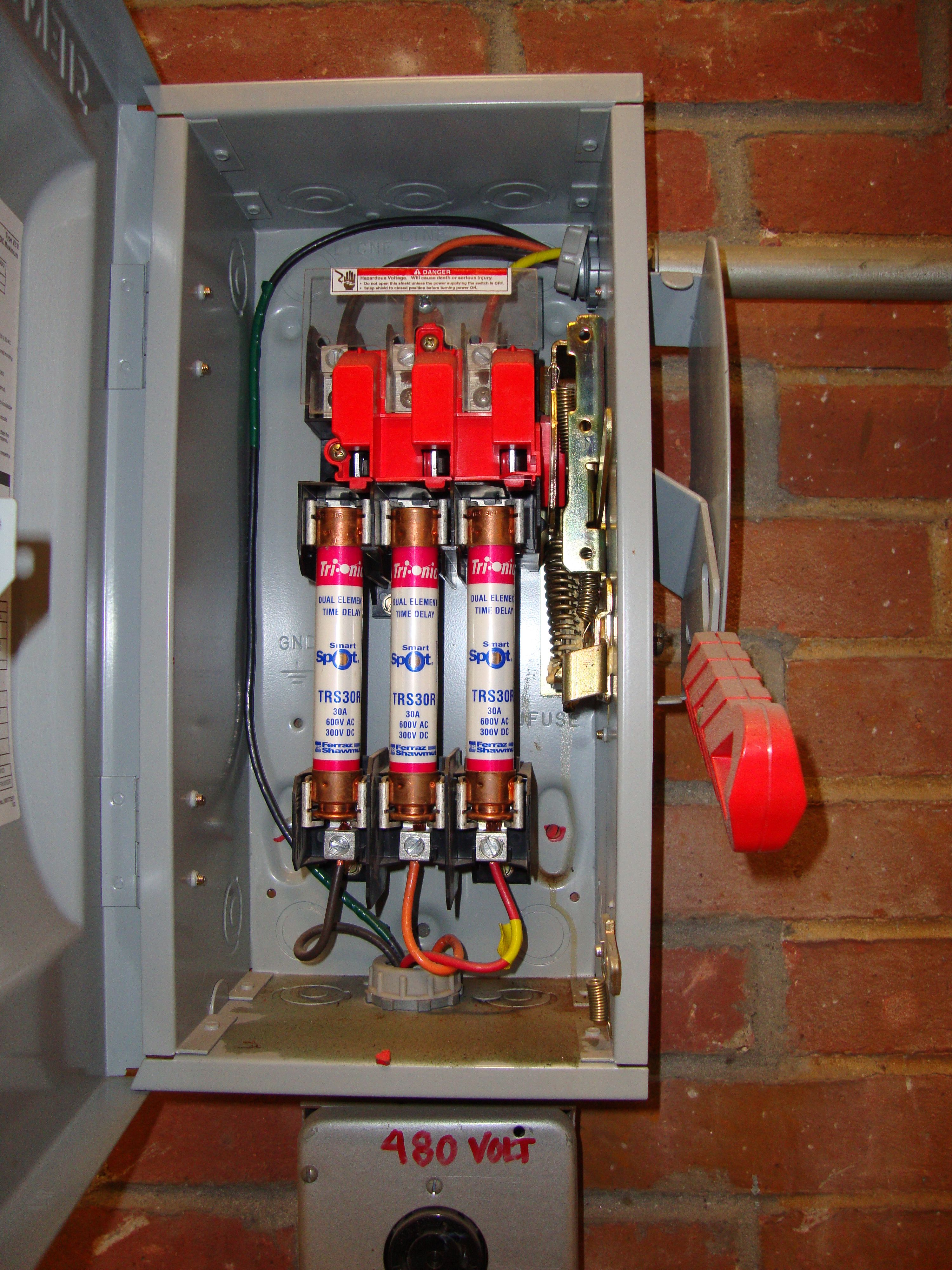

Lets begin this new forum topic regarding the new IEEE 1584 and electrode configurations with a simple low voltage fusible disconnect. What are your thoughts regarding which electrode configuration(s) to use?
Please provide your thoughts about the configuration and the specific location on the equipment if applicable.

The fuse clips could be HCB. The lugs could be VCBB. All else being equal, if you run the calcs on both HCB and VCBB, HCB gives you the higher incident energy. So I would use HCB.

IEEE 1584-2018 Annex C.4 says "VCBB is likely to be the best configuration." So from that language, I wouldn't have a problem using VCBB.
That is correct, you have to follow the flow of current, This is an opinion, however, the majority of the nodes in a typical 600V Class study are going to be VCBB, The notable exceptions are all bus plugs and breakers in true switchgear construction (versus swithchboard construction), these are horizontal.
Also be cautious on how you classify the low voltage side of a pad mount transformer. Those appear to be horizontal, however, the LV chamber is a hybrid open-air enclosure with extremely large bus separation. The bus separation could be 6"-12".
