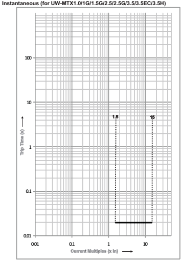

The <240V, single 125kVA transformer exception has left me baffled.
I really need to clarify. The NFPA70E-2012 edition removed the exception line, (correct?) and refers people to the IEEE 1584-2002 standard. The IEEE 1584-2002 standard allows us to neglect anything less than 240V and fed by a single 125kVA transformer or less. So, in a sense, the same rules apply as before, however instead of explicitly calling out the exception in the NFPA70E-2012, they refer us back to the IEEE 1584-2002 exception. Is this right?
Reason I'm asking: The 208V panel and 4 accompanying 208V panels show in my attached PDF have an arc flash category of 3. This seems too high. I believe that because arcing fault at the breaker is so low, that it releases in the thermal region at about 40 seconds. I have attached a PDF with the oneline, TCC, and arc flash table.
Any advice would be greatly appreciated. Thank you.
PostPosted: Fri Nov 02, 2012 3:37 pm
Not quite there yet. 70E itself does not make any reference to any particular method at all in the body. The annex gives no less than 8 different methods. Of those, just one is IEEE 1584. And IEEE 1584 is the only method that contains the exception you are referring to. So if you are using one of the other methods, then the exception would not apply. It is left up to you as the end user to determine which method you feel is the most valid. In many cases, it isn't. For instance we have 23 kV buses where I work at. IEEE 1584 is not valid above 15 kV. The only calculation given in IEEE 1584 for this voltage range is the Lee method and that method is exponentially less accurate as voltage increases.
So strictly speaking it was correct to delete the low voltage exception out of 70E because that is a peculiarity with a particular calculation method. If you use IEEE 1584 as the method of choice then at least with the current edition, the exception exists.
There is another "exception" in IEEE 1584. They acknowledge that beyond 2 seconds, anyone within the vicinity of an arc flash would either attempt to escape on their own or be physically pushed out of the area by the arc blast. The language within IEEE 1584 in this regard isn't that good but almost all engineers cut off the arcing time at 2 seconds. I don't have the parameters used in your calculation but if you used 40 seconds for an opening time instead of 2 seconds, then the incident energy would be 20 times higher than typically calculated. Applying the 2 second cutoff would reduce the incident energy to <1.2 cal/cm^2.
PostPosted: Fri Nov 02, 2012 4:08 pm
Joined: Tue Sep 11, 2012 9:55 am
Location: Portland, OR
Thanks for your reply Paul. I appreciate the clarifications (I didn't know there were 8 different calculation methods...).
I used 2 seconds in my calculations. I am using the "NFPA70E-2012 Annex D.7 IEEE 1584 - Preferred Method (CSA-Z462 Annex D.7)" calculation method in SKM.
I guess the moral of the story is that without employing the "exception" a person at this panel could be exposed to a high amount of incident energy based upon my calculations. And, without employing the exception I would advise wearing a cat. 3 suit unless the client wanted to spend the money on a more faster-acting breaker or maybe install a fast-acting fuse. At the end of the day I'm most concerned with worker safety and I want to feel confident in the end results of the analysis.
PostPosted: Sun Nov 04, 2012 4:37 pm
If you don't apply the exception then instead of SPF 15, you'd recommend a 40 cal/cm^2 for spending an hour at the beach!
