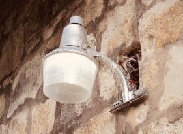

Certainly a bit creative with the mounting. An "A" for effort?
Your thoughts?
 Post subject: Re: Creative Mounting of a Light
PostPosted: Fri Feb 22, 2019 10:17 am
See NEC 314.25, 410.22 & 410.96
