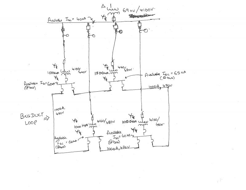

Get and use the AB Chance multi range detector. It comes with a self test device and is designed to be used with a hot stick. Select the stick for the voltage you are dealing with . Don't forget it is an induction device and won't read any DC static voltage that may be present . You must still apply grounds from the proper distance, or discharge the equipment before making bare-hand contact.
