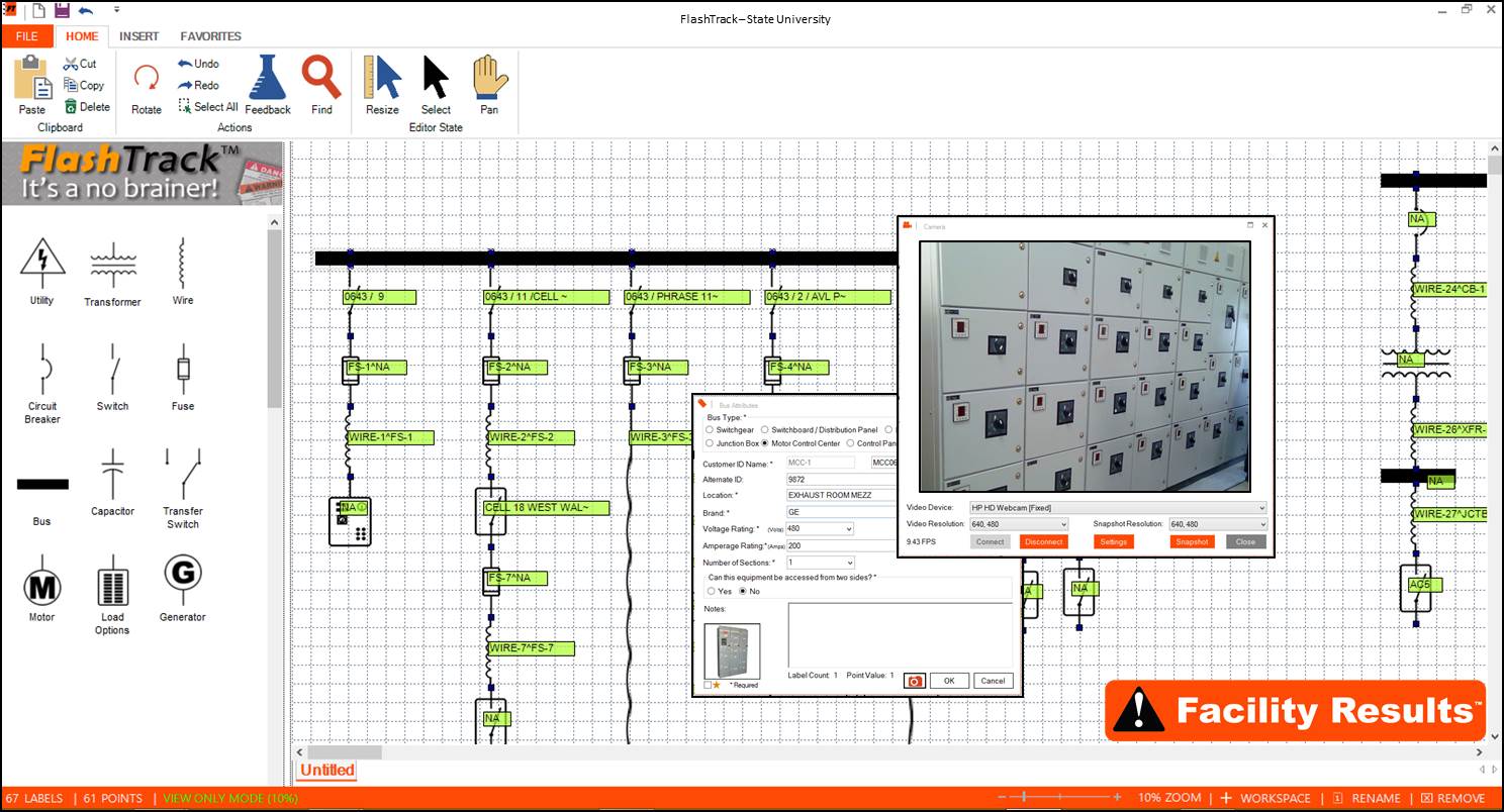

There are situations where increasing the working distance a few inches from the IEEE-1584 standard can mitigate the incident energy hazard. In the attached example, increasing the working distance from 18 inches to 22 inches “reduced� the hazard from over 40 cal/cm2 to exactly 40 cal/cm2. I’ve read posts in this forum where people mention non-standard working distances as a mitigation option, but I haven’t seen specific examples of the labels. I’m posting my proposed labeling scheme for your (constructive) feedback.
The attached example is for a building 800A main distribution panel. The top label shows that the location is “dangerous� and shouldn’t be worked on while energized at the standard working distance. The next label would be placed directly underneath the standard label. The purpose of the non-standard label is to indicate the non-standard-working-distance and the non-standard-hazard.
I recognize that some people will think this may not be a good idea (http://www.arcflashforum.com/threads/1204/#post-5996). I recognize that to safely use these labels there would need to be additional procedures for my facility’s electrical safety work practices program. I recognize that there are additional liability concerns when deviating from the IEEE 1584 standard working distance. I recognize that at some distance, it would be inappropriate to expect safe work to take place.
Expensive new equipment mitigation solutions are just not realistic for many existing facilities. These labels could be helpful and appropriate for hot stick situations. These labels could be helpful at locations with 40.5 cal/cm2 available. These labels are not the solution to all the world’s arc flash problems, but I believe they could be part of the solution for specific situations. I’ve seen plenty of standard arc flash label examples, how about sharing your “non-standard working distance label�? How about some feedback on my proposed label?
