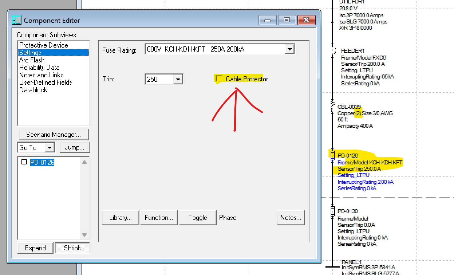

What Mike said although I seem to recall that there is a check box on some screen somewhere that says Cable Protector but I don't recall now where what screen or what checking the box does. I don't run into those often.
 Post subject: Re: EPRI - Has anyone used this? 1584 O.O.B.
PostPosted: Wed Mar 11, 2026 9:45 am
Found it. The cable protector check box appears when you have parallel sets of cable for a feeder. Checking the box will divide the fault current between the number of parallel sets, so the fault current "seen" by the cable protectors will be a half or a third, or a fourth or whatever the number of parallel sets you have and do the math for clearing based on that.

Thanks Mike, so then would you typically model the paralleled cables individually as well? For example, we have 5 parallel #600 kcmil sets to make a 2000A feeder. Each wire gets a 400A cable limiter; however, it seems wrong to use a 400A fuse in SKM unless they are taking that into account.

Thanks Brent,
I do wonder how that tripping mechanism would play out in reality. Like I can see a scenario where the load end of the only half of the wires gets shorted; it doesn't seem like all of the cable limiters would trip in this scenario. If that is the case, there would only be INCREASED resistance (not the infinite resistance we see in an open circuit). If that's true, then dividing the available fault current at a given point does not follow the Kirchoff Current Law. The Current doesn't go from V/(5R) to V/0 (infinite, open circuit), it goes from V/(5R) to V/(4R), then V/(3R) if that cable limiter blows at all.
Guess I need to do more research on these...

On my phone so short answer. The limiters are not sized by amps. They are by cable size. They are pretty much just short circuit protection for a single cable so if you have a cable fault it takes that cable out very fast and your system stays online with a little less ampacity. If you look at the TCC for a #500 limiter it would have like a 2000 or 2500 amp long time rating if it had such a rating. So no overload protection just short circuit protection.
PostPosted: Thu Mar 12, 2026 3:26 am
I just went back and looked at an old job where I had compared #500 cable limiters to a Eaton Magnum DS limiter installed in the gear in series with the breaker and a fuse. It looks like my memory failed me. If the #500 cable limiter had such a thing as a long time rating, it would be around 1000 amps, not 2000-2500a that I mentioned yesterday.
