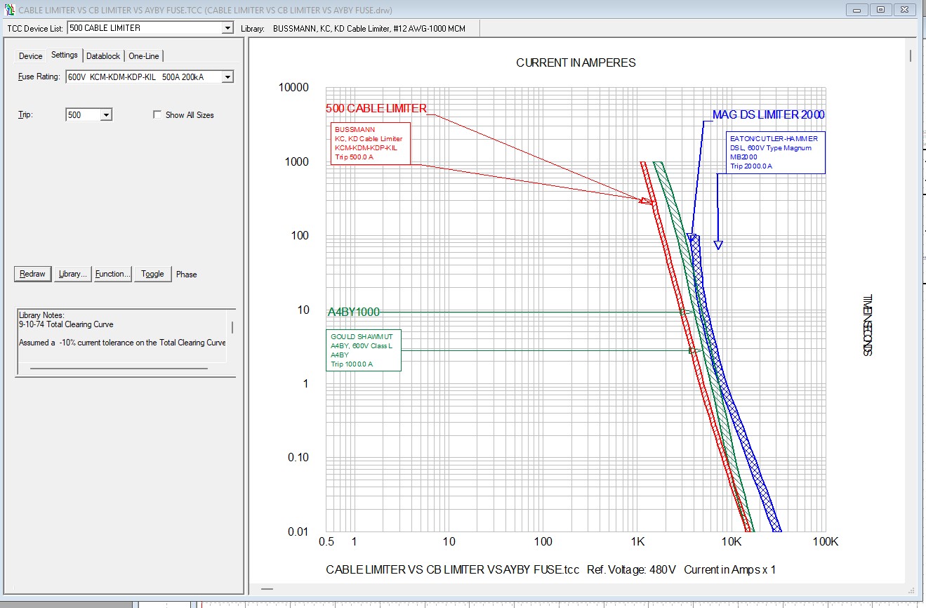

On my phone so short answer. The limiters are not sized by amps. They are by cable size. They are pretty much just short circuit protection for a single cable so if you have a cable fault it takes that cable out very fast and your system stays online with a little less ampacity. If you look at the TCC for a #500 limiter it would have like a 2000 or 2500 amp long time rating if it had such a rating. So no overload protection just short circuit protection.
 Post subject: Re: EPRI - Has anyone used this? 1584 O.O.B.
PostPosted: Thu Mar 12, 2026 3:26 am
I just went back and looked at an old job where I had compared #500 cable limiters to a Eaton Magnum DS limiter installed in the gear in series with the breaker and a fuse. It looks like my memory failed me. If the #500 cable limiter had such a thing as a long time rating, it would be around 1000 amps, not 2000-2500a that I mentioned yesterday.
