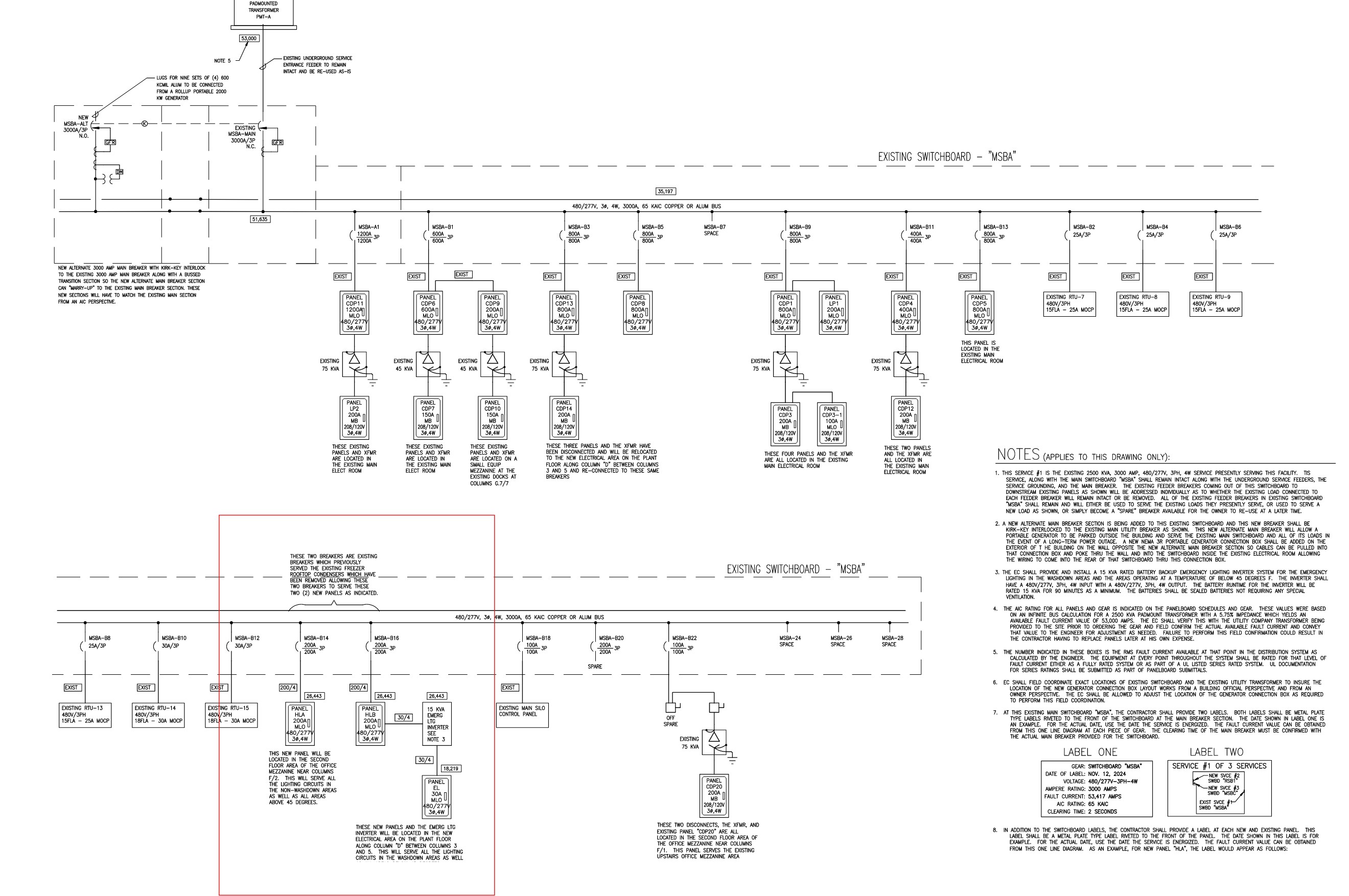

I was asked to provide labels on the new equipment that was installed.
I have the utility details, MSBA details and I have the panel details. Do I need to model the whole Switchboard in SKM or can I just model the Utility, MSBA- Main breaker, MSBA and the two new equipment?
 Post subject: Re: Modeling new equipment.
PostPosted: Fri Feb 07, 2025 4:40 am
Posts: 497
I agree with Mike's assessment. That is a small system and wouldn't take long to model. The time consuming part will be getting all the data.
