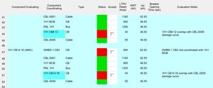

I was trying to do an auto coordination and evaluation on SKM. Does anyone know what the colors mean? I know red has to be a warning and green is good. What about the other colors?

I don't care for SKM's coloring of different arc flash values. They are a software company, not safety experts.
We all understand Red means Stop and to stay away. But, for most of us Green means Go and it is safe to proceed. Do we want any of our employees thinking Arc Flash is safe?
