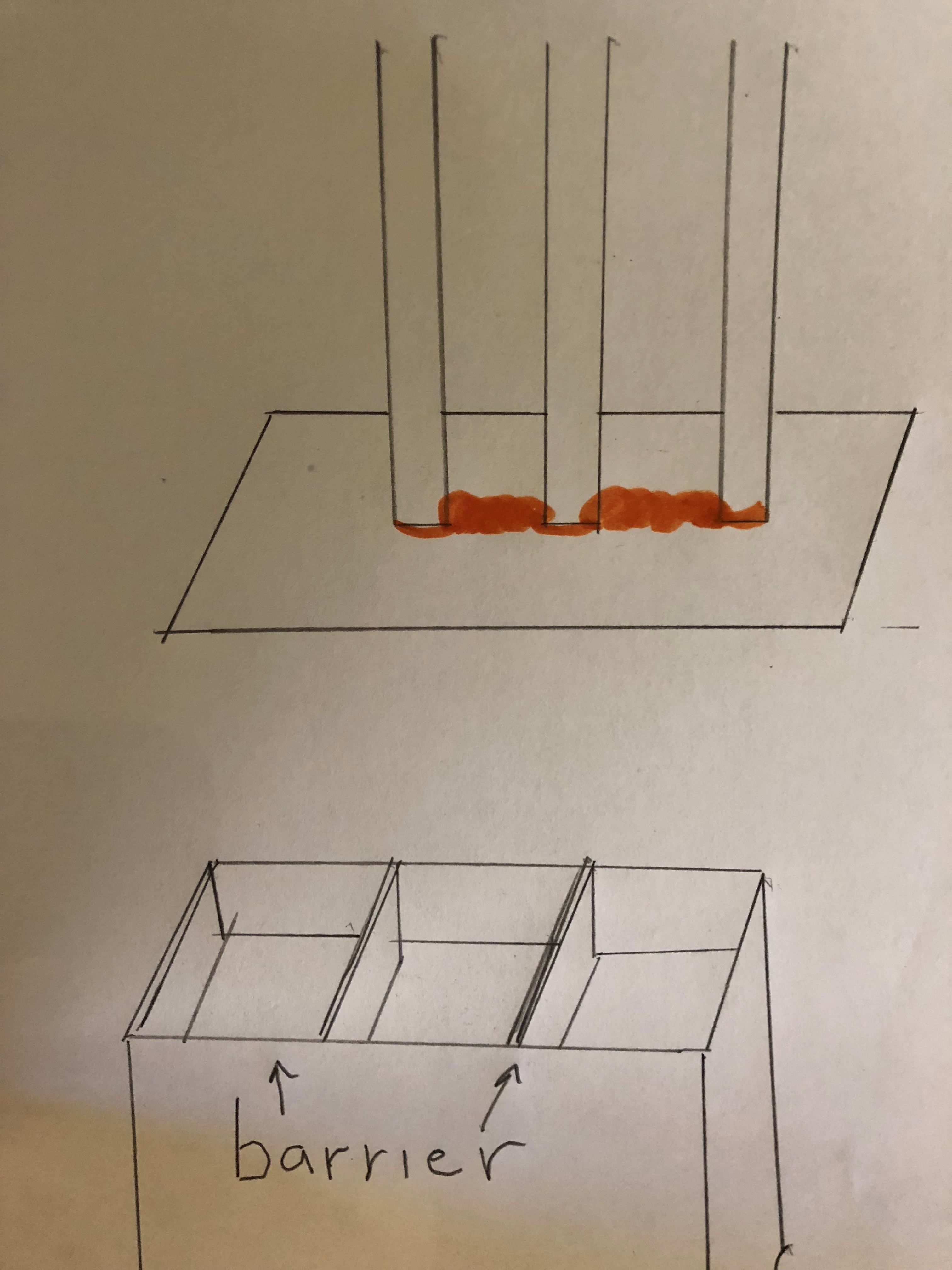

I still struggle with the concept of a "barrier". I've seen the tests. Most of them have basically a solid block of something (ceramic) clamped around the bus bars. I could be inclined to agree that this is representative for instance of terminating into the top of a breaker or a contactor.
So what constitutes a substantial enough barrier to trigger the increased incident energy in a VCBB configuration vs. the much less dangerous VCB configuration?
I am not sure this is being properly interpreted. My (poor) sketch shows what I believe is the test set up for VCBB on the top of the diagram. It appears that many believe the line side of a main circuit breaker is VCBB. For the test, the electrodes terminate on a flat surface with no obstruction in between the phases so the plasma of all three phases is in one plane.
For a circuit breaker there are barriers between the incoming lugs - bottom of sketch. Wouldn't the insulating barriers possibly stop the plasma of all three phases from connecting and escalating? I really question where VCBB conditions (as the test was performed) actually exists. It seems we are looking at two different things, a flat surface and a surface with barriers in between phases.

100%. None of the IEEE 1584 tests that are used for calibration of the model include actual equipment.
Verification and exploratory tests use actual equipment or mock ups. For instance barrier tests came into being specifically because of mock up/actual equipment tests. This article from Mersen summarizes the tests that they did, that were the basis for the reason that the barrier tests were done:
https://ep-ca.mersen.com/fileadmin/cata ... -Paper.pdf
One problem with using actual equipment is that the stuff in the cabinet changes the result, often quite dramatically. The example of a main breaker in an MCC with little to nothing else within the cabinet is one example where incident energy goes up compared to vertical electrodes hanging in an empty box (VCB). But by the time you include all the little parts that are stuffed into a typical MCC bucket they are energy absorbers and reflectors and decrease incident energy. In the case of MCC buckets in particular where the worst case incident energy is represented by arcing across the bus behind the buckets, it is quite a bit lower.
For comparison look at the free EPRI arc flash tests on their web site. They do actual equipment tests instead of lab models like IEEE 1584. The results are dramatically lower than that predcted by IEEE 1584. See for instance this article describing the overall results which is very different (drastically lower in most cases) from IEEE 1584 calculations:
I can't find the article but one of the experiments that was published referring to various barrier configurations considered that in some switchgear there are very extensive sheets of glastic in place usually called phase barriers that all but make each individual phase it's own box. These aren't the shallow finger-safe boxes in your sketch but something much more substantial in size. The hypothesis was that this should prevent a 3 phase arc from forming and that we'd be looking at single phase cases, and that from a practical point of view it would be really easy to retrofit most equipment with phase barriers. Equipment with phase barriers is built specifically on the idea that it makes a big difference. Or at least that it would delay the onset of 3 phase arcing faults to the point where maybe we could try to stop a true 3 phase arcing fault from occurring and reap the rewards of reduced energy. At the time it was also believed that single phase arcs would have far less incident energy (divide by 3 was suggested in a lot of sources).
However the test results showed something far different: First off even when the test was modified so that only a single phase arc could occur, the incident energy was not much different from a 3 phase arcing fault. So the idea of single phase incident energy being dramatically lower is invalidated.
Second the phase barriers didn't make much difference at all. Once the super heated air expanded and spread throughout the enclosure area, a 3 phase arcing fault ensued. This occurred at roughly 1 to 2 cycles into an arcing fault both with and without phase barriers. They didn't make much difference at all in most cases.
So to answer your question and sorry that I can't give a reference but phase barriers don't make much difference at all. So the little short finger-safe type barriers you are referring to are even less of a barrier and won't make any difference at all.
