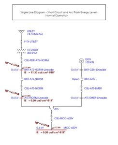

Pretty new here but liking the learning atmosphere. I've just started doing some arc flash studies and just wondering how critical certain data is to a study.
The system I'll do studies on is pretty much the same SLD with some minor changes (additional pump,etc.). MCC-600V has SMC/pumps attached (not shown on pic).
1. Cable lengths/resistances - how accurate should you be? I've seen some consultants who did studies for us put in a tolerance of +/- 10% and eyeball the lengths. Are cable lengths from the SMC to the pump critical? Do you need to diligently gather all the cable sizes and lengths? Or overall, given the +/- 10% assumption that it wouldn't be a big deal in the end?
2. If the pumps/motors are run by a SMC (soft starter), can you assume that there will be no fault/current contribution coming from them?
3. When having multiple pumps (say 3) in the MCC, what scenarios should be run? I've usually just seen worst case, which is to assume all pumps are running and add all the HP into one composite load. Is there any value in running a scenario when only 1 or 2 pumps are running?
4. For the ETAP gurus, I've seen different results from different ETAP versions using the exact same data(ie. breaker type, etc). Would it be attributed to updated device model/characteristics for the same device (ie. Square-D/KAL, 200A, 0.600kV) between different ETAP versions?

jvito wrote:
Hi all,
As with everything, it depends! First off you have several impedances: the source transformer (or generator) impedance, the cable impedance, potentially the load impedance. Generally we are looking at the sum X1+X2+X3 but when one of these impedances dominates, the others don't matter. So with short cables, bus bars, etc., cable impedance is almost immaterial (transformer impedance dominates). But at longer distances (tens to hundreds of feet or more), cable impedance dominates and that's where it affects current. Now this is where it gets a little more complicated. If the operation of the OCPD is in a definite time region such as "instantaneous" tripping then lower impedances decreases incident energy so frankly a low error doesn't hurt anything. But if the overcurrent protective device is in an inverse time region (trips faster with higher currents) which is the case with all fuses and many breakers and it is using one of the "typical" curves we see in power distribution (ANSI inverse, very inverse, or extremely inverse), then as current drops time increases exponentially causing the net incident energy to actually increase. So paradoxically getting the cable size wrong on the low side is now detrimental and eliminating them altogether is definitely a bad idea. By looking at the predicted arcing current and the TCC's you can observe which part of the curve you are on and what the net effect of a measurement error will be, and act accordingly.
SMC is AB's product line name just like Square D uses Altistart and ABB uses PST. Soft starter is the generic term. It depends on the design. A soft start with a bypass contactor is essentially the same as a starter so you'd assume fault contribution from the motor exists. If however it is a "full time" soft starter without a bypass contactor then any fault current would have to flow inversely through the soft starter which is not likely or even if it is, too low level to matter. So summarizing the general rule is to not model the stuff on the other side of a VFD, but you do model the stuff on the other side of a soft starter, IN GENERAL. But you need to verify which particular equipment configuration you have since there are VFD's with bypass contactors, particularly around hospitals and water palnts, and there are soft starters without bypass contactors but that's not the most common design except with very small soft starters since it provides an efficiency boost, greater reliability, and a smaller enclosure for a negligible amount of additional costs.
This gets into modelling here the general theory is to ignore motors that are under 50 HP as their fault contribution (inductance) is negligible, add together the HP or all motors from 50 HP up to around 150 HP and treat it as one large motor, and model all larger motors individually. The inductance contributes fault current. So you need to model it but also take into consideration diversity...if we have say 3 pumps but only 2 can realistically run at a time, then we model 2 pumps, not 3. This is in the short circuit system analysis standards (IEC and ANSI). I suggest reading up on the requirements for the standard you are implementing for your short circuit analysis.

jvito wrote:
First off, is there any book or material you can recommend that has all these "rules of thumb and/or modelling rules"? Or you just get them from experience?
This is in the ANSI standard I believe. I don't think IEC mentions it.
What you say makes sense with regard to cable lengths. For my case, it would probably 100 ft max from the utility power...plus other smaller lengths..so fairly negligible. I doubt total cable lengths would even add up to 200 ft.
Take your model and adjust the cable lengths with some typical values you would expect. Run it a few times and write down the incident energy. It will quickly become obvious when accuracy matters.
What I did was get the name plate data from the field for the OCPD (breaker and fuses) and find them in ETAP's libraries to get the other device characteristics (impedance, TCCS). This is what the consultants we hired before did, and to me this makes sense. But my boss is hesitant and thinks we might be missing significant data by relying on ETAP libraries. What is the usual procedure for this? Can we request data (relevant to arc flash) direct from the manufacturer?
You can but building your own models in the software is tedious. The software companies take great pains in getting this right. I would definitely rely on the libraries when there is an available, correct solution. If you are really worried about it, you can easily get TCC's off manufacturer web sites. Look at the opening time predicted by the model based on the predicted current. Compare this to the manufacturer's published data. Note that there are tolerances to watch out for, too.

jvito wrote:
Would this (having no fault contribution) also apply to overload relays (E300) ? It seems to me that it functions similar to VFD and SMC and also has its own protection.
No. An overload relay is a passive device that monitors current and generates a trip signal for a contactor. Two reasons not to consider this. It does not limit fault current in any way. Furthermore, a contactor is limited to interrupting fault currents up to roughly 6-10 times it's rating. It is nowhere near the 20+ times rated current interruption capabilities of fuses and breakers.
Second overload relays are way too slow. The NEMA rated ones are rated in terms of how fast they trip at 6x FLA. So for instance a class 20 relay trips in 20 seconds at 600% of FLA. They are rated to trip in several minutes at 2x FLA. Any arc flash would be over before the overload relay gets close to tripping. But there's an exception and you're getting close to it. More advanced motor protection relays can trigger on jam or locked rotor conditions at much faster trip times. This is beneficial for larger and medium voltage motors. And they can be used in the same way as "fuse savers" tripping on low level faults instead of tripping fuses or breakers. BUT use of such things has to also consider the maximum contactor rating and to suppress tripping if the current exceeds the contactor's capabilities or the contactor is destroyed. So yes in some ways you could say an overload relay can be used in this way but it's not a typical scenario to consider and certainly not one that we'd typically rely on in protection scenarios (arcing and short circuit faults).
