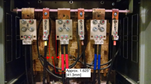

So I came across this installation by chance and decided to check for reference, and figured I would share my findings.
That's one out of how many different configurations?
I'm going to stick with not labeling them and our "shut it down if it's not labeled" policy. I'd rather do that than put a sticker on it with the wrong data.
As mentioned before, a generic DANGER - SHUTDOWN REQUIRED would also work over putting a label on it with arbitrary or erroneous IE and PPE listed.
