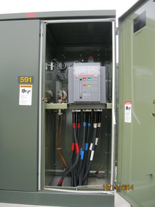

Hi All.
I know I've seen a picture or two of your typical oil filled pad mounted transformer that had fuses or a breaker installed right off the paddles on the secondary compartment. I tried googling it and could not find any.
I've asked our ABB and Cooper reps if they offer and factory installed breakers or fuses and they both said "no".
Has anyone come across anything like this? I realize on the bigger sizes it may be very difficult to do and be able to get several sets of parallel 500's landed due to limited room but there would be some instances where it could be an advantage to "move the problem" from the line side of the switchboard main out to the transformer.
Thanks.

Maybe this is what I saw?

I have not seen the big XFMR companies do this but a local re-wind shop had done this for a wind farm. The fuses were bolted directly to the stabs and the other end was bolted to cables that were strapped down to strut. The strut went from side to side in the LV cubical.
No analysis was done to study the movement during a fault but the XFMR company felt comfortable in this configuration. I do not recall if there was any insulating board installed.

I saw this at a wind farm on a 1750kVA, 12.47Y/575 txf.
That looks like a very good install. Thanks for sharing.
