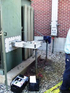

Where a worker could potentially make contact with exposed energized parts is NOT the only situation in which an electrical hazard could exist. Even if suitable guarding exists to protect against electric shock hazards, it does not mean that an arc flash hazard can’t still be present, and the likelihood of an arc flash event increases significantly with worker interaction.
The major difference between a 120V, 20A convenience receptacle and a IP2X complaint 480V, 1500A busway is the amount of energy available. Attached are images of a 480V, 2500A busway <15 yrs. old with a large hole where a bolt used to be; note the scorched area on the ground surrounding the fault location.
You stated that the bus plug disconnects are interlocked and therefore it is impossible for the disconnect on the plug to be closed until the plug is fully seated into the busway… I’ve seen brand new right out the box plugs with manufacturer issues, and often times we aren’t pulling a brand new plug out of a box but rather taking something off an in-house shelf that has been previously used (either simple inspection or refurbishment).
If you looked at the manufacturer’s installation instructions posted on the inside of the bus plug door, it likely says to de-energize busway before installation. If performing this task while energized, I at least hope your guys are wearing PPE…
