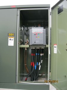

I am curious on what people think of this arrangement and perhaps they have seen it before. This is a 1750kVA, 12.47kV - 575V, pad mount transformer with a circuit breaker for the secondary side mounted inside the cabinet. So to reset the breaker or if one wants to read amperage or other info off the display, the transformer doors need to be opened. The incident energy level is around 28 cal/cm^2, so one would have to suit up to open the doors.
I have attached a picture of the set up.

Neat, but I have never seen a setup like that before.
A few questions about your IE calculation:
Are you calculating the incident energy at the load side of the breaker, line side, or transformer bushings?
What gap distance did you use?
What is the XF primary protection mechanism / type?
In short I am surprised the worst case IE calculation is only 28 c/c2.
Also curious do those feeders run into a cable vault?

Typo on my end, it should be 128 cal/cm2.
The gap distance used was 32 mm for <600V equipment.
Primary protection is a 100T fuse link.
The feeders run into a vault below the pad mount transformer.

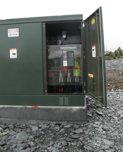

BBA inc. has done that type energy calculation and risk assessment in wind farms applications. It’s used to lower the energy level when the operator needs to open the wind turbine infeed cabinet. The breaker in the padmount is used as the primary protection for that cabinet. For the padmount secondary side energy calculation, the gap we used is the breaker gap distance, typically 32 mm and the primary side fuse protection will be the protective device interrupting the arc fault. PPE will be at 4 or >4 so a special risk assessment is made for the operator that will need to lock the breaker off or reset it. In the assessment an upstream disconnect switch (internally in the primary side of the transformer) is used. Furthermore, a plexiglass around the breaker is added for protection. We don’t recommend operating the breaker with the transformer being energized.
Daniel Lebeau, eng.

A breaker in the secondary compartment looks intriguing, but like others have said there would still exist a large amount of potential incident energy between the transformer secondary bushings and the line side of the circuit breaker.
Has anyone looked at using a switch in the primary compartment activated by a relay using CTs installed on the secondary side of the transformer? It would seem like this would provide a better solution than either a secondary circuit breaker or primary fuses. You wouldn't have to worry about the problem mentioned above, and it could be set to trip faster than primary fuses since transformer magnetizing inrush doesn't have to be accounted for (CTs on secondary side).
Cooper has a product marketed as their VFI Transformer which looks like it could be setup this way. Has anyone had any experience using this scheme to reduce arc flash hazard levels?
Any other thoughts as to why a solution like this would or wouldn't work?

It works. The scheme is called a virtual breaker. Use bushing CTs so the high incident area is essentially nil. I used an SEL 651 but separatebreakers work, too. Reclosers/breakers for 15-35 kv run around $18-$25k from Elastimold, Tavrida, and occasionally Cooper. Fuse cutouts run $10k installed so there is a price bump but not excessively high. Ifit is low voltage, you'd need a breaker with a shunt trip input and either a battery backup or capacitive trip device.
