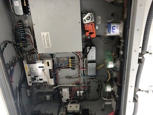

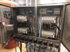

We have Arc Study done on our equipment,
The questions have come about from resetting, equipment downstream from the MCC's
We have 2 Make up air(MUA) units that "overload" due to their design and the wind putting out the flame. They are fed by 600v main breaker power.
Operators were opening the MUA cabinet and resetting it, but through review, the rest of the cabinet was live so we reviewed and determined that electricians should be doing that task. Photo attached
the other question that came up was Operations open up a cabinet to look and see if UV bulbs(photo attached) have been out, the cabinet is fed from a 120/208 panel and 2012 arc study determined it HRC 0. So im assuming that would mean they are ok with opening the cabinet and looking in. Given they are wearing 1.2 cal/cm2 clothing?

 Post subject: Re: Resetting breakers for Operations (non electrical worker
PostPosted: Fri Dec 20, 2019 3:28 pm
Remember, people can be trained and then qualified to perform specific electrical tasks, without being qualified for all tasks.
I see nothing wrong with developing the steps to qualify an operator how to open an energized MAU in order to see if a flame is present. That is not the same thing as resetting an overcurrent protective device which has opened.
It is your company's electrical Safe Work Practices that are important. The body of NFPA70E does not even use the word 'electrician' except once as an informational note.

PostPosted: Mon Dec 23, 2019 3:58 pm
Joined: Mon Dec 09, 2019 1:32 pm
Thanks, for the great info.
Its not that they only look to see(the code) if the flame is out, they also reset the switch. When all the rest of the cabinet is energized(to isolate, its main plant power). So its been a head scratcher.
PostPosted: Thu Dec 26, 2019 10:04 am
Again, there may be nothing inherently wrong with them resetting a switch. People can be trained, and qualified, to do anything.
Your policy needs to consider things like:
Does the resetting need to be done because there is no flame, or because an excess amount of current flowed, causing a protective device to operate?
Was the excess amount of current beyond the normal operating conditions of the device (e.g. <600%) or did some repair need to be performed?
For the most part NFPA70E is black and white in only one area - Employers need to have safe electrical work practices for their employees. Other than that NFPA70E is intentionally gray in the 'do it this way' language.
