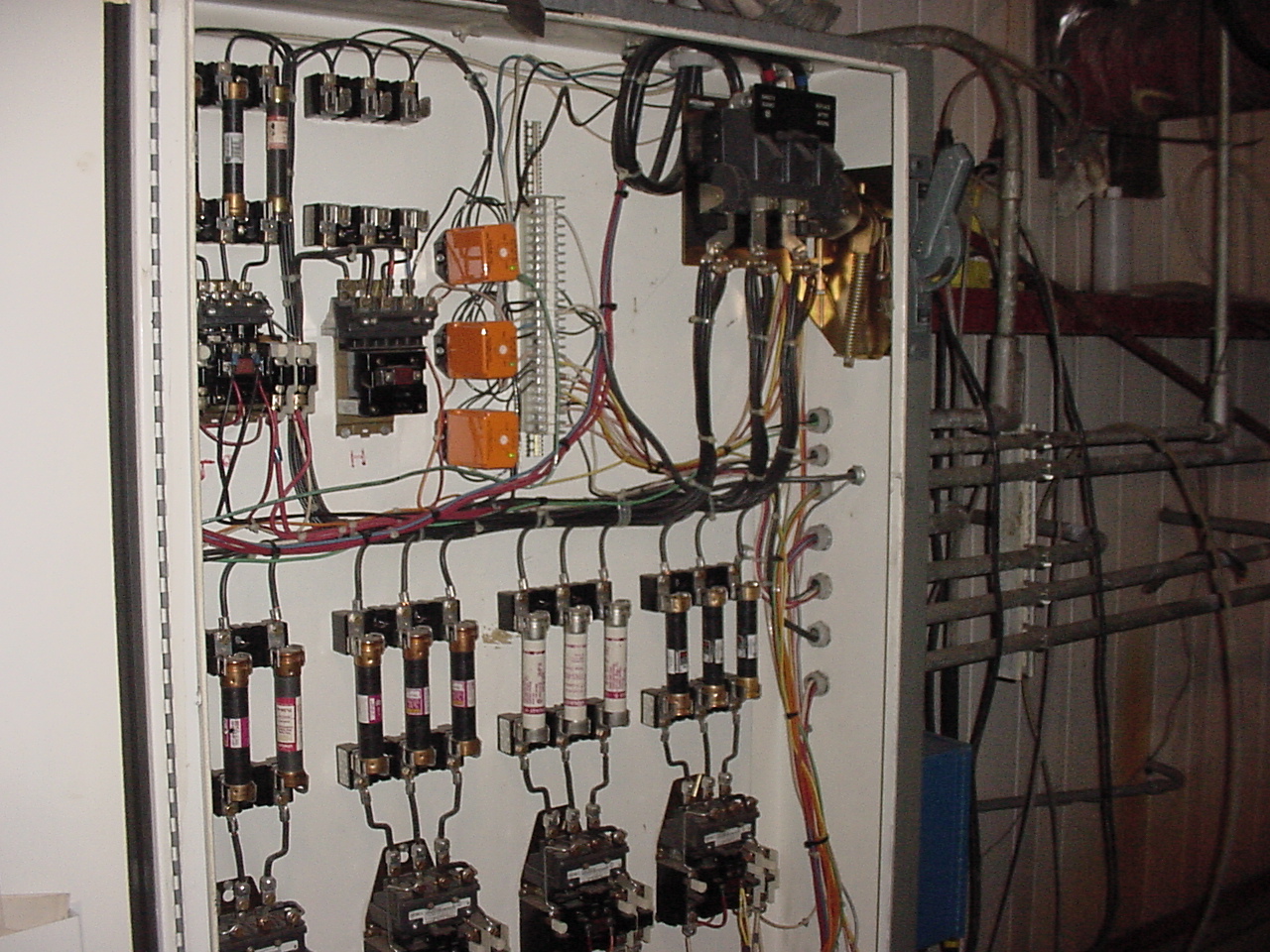

What electrode configuration would you use?

Fuse clips could be VCBB or HCB. At the breakers and motor starters it is VCBB. All else being equal, if you run the calc's on both VCBB and HCB, HCB will give you the higher incident energy. So I would use HCB. |

vCBB unless the dimensions work out to shallow which this has to be close. Due to enclosure sjze VOA might be more appropriate though. When does CF reduce VCB 5o equal VOA? |

I tried varying box sizes with the IEEE1584 Excel Calculator and found that with 480V, 20kA bolted fault, 1" gap, 24" working distance, 200 ms arc duration, VOA gives 2.15 cal/cm². Increasing box size from 20"x20" to 60" x 60" in 5" increments, results in IE reducing from 4.56 cal/cm² to 3.44 al/cm² at 50" x 50" and not reducing for larger sizes. Most likely that interpolations too far beyond the tested sizes to not result in values approaching the open air case. |

jghrist wrote: I tried varying box sizes with the IEEE1584 Excel Calculator and found that with 480V, 20kA bolted fault, 1" gap, 24" working distance, 200 ms arc duration, VOA gives 2.15 cal/cm². Increasing box size from 20"x20" to 60" x 60" in 5" increments, results in IE reducing from 4.56 cal/cm² to 3.44 al/cm² at 50" x 50" and not reducing for larger sizes. Most likely that interpolations too far beyond the tested sizes to not result in values approaching the open air case. The adjustment stops at 1244 mm. |
