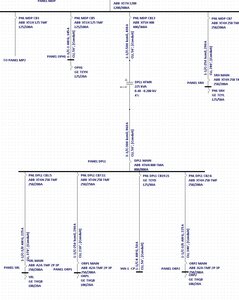

Hello, I am working on this Arc Flash study for a company that wants the Incident energy levels below 4 cal. I can figure out why these ones are so high.
| Attachments: |

Also, is that EasyPower? Should your most downstream feeders be 3-1/C, not 1-1/C? Not an EasyPower user so not sure. Attachment:
_________________ SKM jockey for hire PE in 17 states

Hey, I posted the Arc Fault from the bus. And yes this is easypower. Do i have the conductors wrong? 3-1/C instead of 1-1/C?

I looked at the curves with the XT4-N set to MIN. It looks like your energy is based on the A2A breaker tripping. At 1900 amps you are in the tolerance band of the breaker and it doesn't trip until well past 2 seconds. That is why you are timing out. You could re-run your study to look at both the line and load side of the main and use the line side with the upstream XT4-N breaker tripping in the instantaneous region. That will get your energy down, I think, on the one that is 1900A arcing current set to MIN. The ones that are only 1200A, neither breaker trips quickly and you still have your "high" incident energy. Attachment:

bbaumer wrote: Also, is that EasyPower? Should your most downstream feeders be 3-1/C, not 1-1/C? Not an EasyPower user so not sure. Attachment: conductors.jpg @bbaumer and also @jsoar: in EasyPower, "3-1/C" means three parallel conductors per phase in a single conductor cable configuration. So the first digit is how many (parallel) line conductors per phase, and the "X/C" is how many conductors in a cable configuration. So if I had a conductor run "1-3/C", that would be something in a 3-conductor cable assembly, such SO cable or something run in cable tray. A 3-phase circuit run showing "1-1/C" would be a standard 3-phase, one conductor-per-phase circuit. (note that neutral and ground are a separate tab and aren't addressed in that nomenclature)
