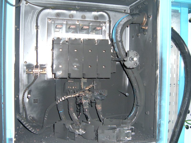

You should just put a simple label that meets the NEC 110.16 requirements, like this one.
