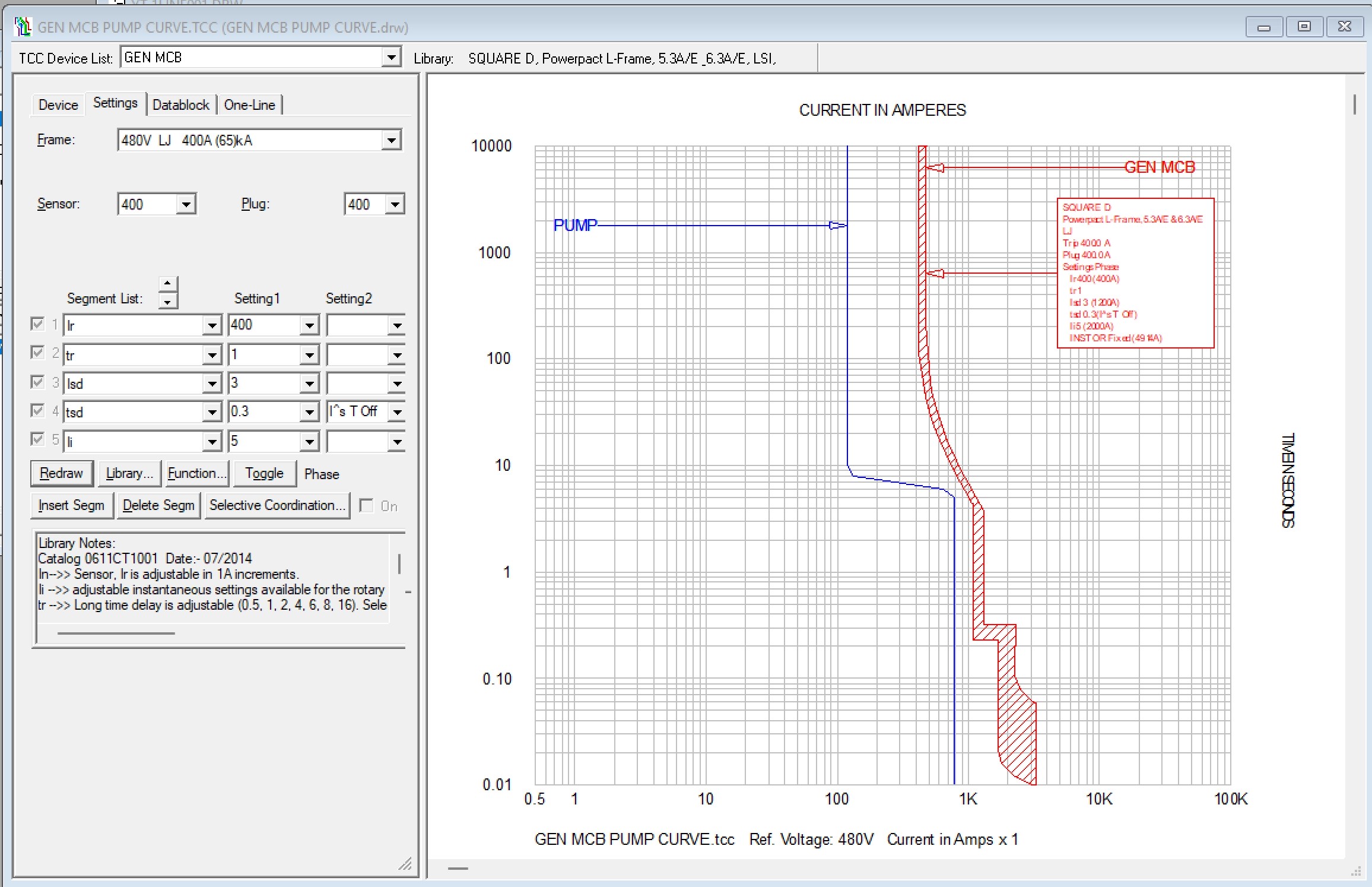

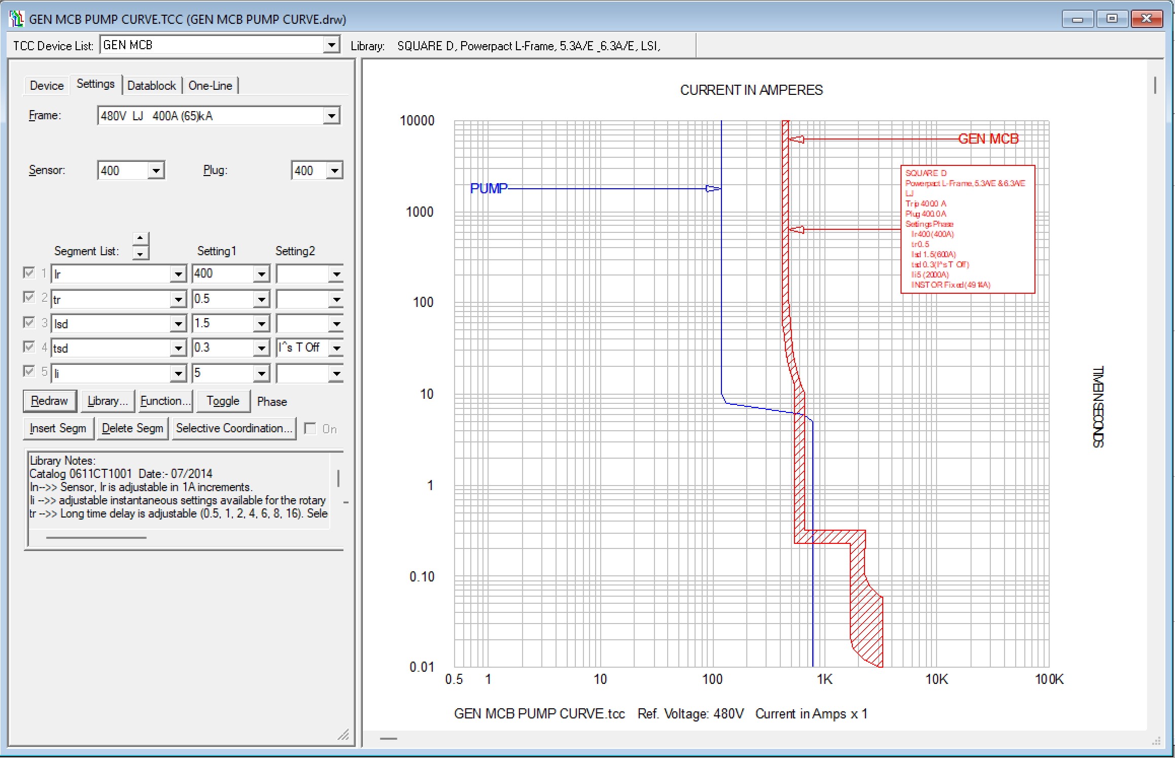

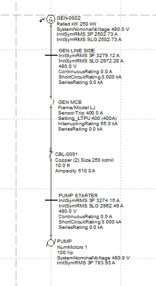

Circling back to this (and touching on a common theme talked about here), when a study indicates a generator breaker will never trip because the fault current is below 2kA (causing it to time out in software), what are the options? In a study I'm working on now, the LT pickup is 320A, the ST pickup is 3200A, and the INST is 7200A(fixed). How does one determine how far one could drop the ST pickup before I'm in danger of tripping under inrush conditions of downstream pumps?

Add the pump motor starting curve to the TCC and coordinate the breaker with the curve.

For example
