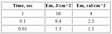

The level of intensity and duration of exposure result in a received thermal dose unit TDU that can be calculated and used to estimate these progressive effects from the following equation[4], [1]:
TDU = I^(4/3) * t * 10^-4, (W/m^2)^(4/3) * sec, Equation 4
where I is radiated heat flux in W/m^2 and t is exposure time in seconds.
Threshold incident energy for ignition or melting of apparel fabrics can be evaluated from Equation 4 above as:
Em = I * t = TDU^0.7 * t^0.25 * 10^3, J/m^2, Equation 5
The TDU for melting of nylon and polyester fabrics is ranging from about 1500 to 3000[1]. As an example, assuming nylons' TDU is equal to 1500, substituting different time intervals into Equation 5 and converting the calculated onset incident energy for melting of nylon to J/cm^2 and cal/cm^2:

Second, and more self-contained, the data shows that at 0.01 seconds of exposure, the limit is 1.3 cal/cm^3 and then jumps to 4 cal/cm^2 at 1 second? This seems backwards.
This is right although it may seem "backwards". For exposures lasting less than one (1) second the heat flux required for ignition or melting the fabrics would significantly increase as the duration of exposure decreased. However, the amount of incident energy required to cause the damage would decrease.
