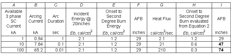

As an example of using Equation 2 above, consider 1, 10 and 100kA faults in 600 Volt grounded switchgear with one (1) inch gap between conductors. The table below summarizes Arcing Current, Incident Energy and the Arc Flash Boundary (AFB) predicted using IEEE P1584 Empirical Model. We deliberately assigned arc duration to 1, 0.1, and 0.01 seconds for the 1, 10 and 100kA faults respectively which is consistent with inverse nature of typical protective device time-current characteristics. Column F lists AFB values calculated using 1.2 cal/cm2 onset to second degree burn Incident Energy recommended by IEEE P1584 Guide. Column I lists AFB values calculated using onset to second degree burn energy evaluated from Equation 2 and published in column H.
Note that the amount of incident energy the person would be exposed to remains the same and equal to 2.1 cal/cm2 in all three instances (Column D). The arc flash boundary also remains the same when Incident Energy at AFB is assigned 1.2 cal/cm2 value onset to second degree burn energy as recommended in IEEE P1584. Therefore applying same onset to second degree burn energy for the above fault scenarios would make them appear to be of same severity. However, the arc flash boundary drastically changes when incident energy at AFB is being evaluated using Equation 2. AFB will now increase with an increase of the available fault current, predicted arcing current and heat flux released by an arc.
Therefore, using onset to second degree burn energy for bare skin exposure fixed to 1.2 cal/cm2 in calculating the arc flash boundary for arc durations other than one (1) second is, as far as we are concerned, open to dispute and, in our strong opinion, heat flux rate should be factored-in when estimating skin damage imposed by an arc flash. Using the 1.2 cal/cm2 energy for exposure times less than one second will result in undervalued arc flash boundaries while resulting in conservative but save arc flash boundaries for exposure times more than one (1) seconds. As the IEEE 1584 Guide states, the Guide’s equations (5.8) and (5.9) [1584 IEEE Guide for Performing Arc-Flash Hazard Calculations. IEEE Industry Applications Society. September 2002. page 13] can be used to calculate the arc flash boundaries with boundary energy other than 1.2 cal/cm2, and we believe the equations should be in fact solved for boundary energy computed using the Equation 2 especially for cased when arc duration is less than one (1) second.

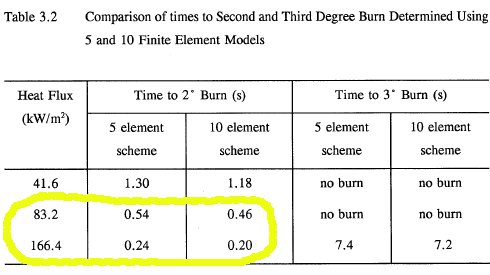

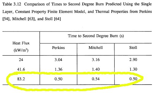

Tables 3.2 and 3.12 from "A Finite Element Model of Heat Transfer in Skin Subjected to A Flash Fire" by David Andrew Torvi, University of Alberta, 1992 list Heat Flux in kW/m^2, not in kJ/m^2. Therefore, your conversion is not exactly right as you missed per second notation. In other words, kW/m^2 is same as kJ/m^2/sec. Now, take the values obtained from converting kW/m^2 to cal/cm^2/sec and compare them with Line A from Figure 1 to see the match. Indeed, 166.4 kW/m^2 (or 3.98 cal/cm^2 /sec ) AND 83.2 kW/m^2 (or 1.99 cal/cm^2/sec ) irradiance is required to cause a 2nd degree burn within 0.2 and 0.5 sec interval respectively, resulting in 3.98 cal/cm^2 /sec x 0.2 sec = 0.8 cal/cm^2 and 1.99 cal/cm^2/sec x 0.5 sec = 1 cal/cm^2 incident energy exposure respectively. What you say is pretty much exactly what I am trying to prove. A quote from the article: "the irradiance required for an injury would significantly increase as the duration of exposure decreased; however, the amount of incident energy required to cause a second degree burn would decrease."
I thank you very much for your input. I've spent more time today researching the topic and I've come up with even more solid evidence supporting points presented in the article.

PostPosted: Fri Apr 27, 2012 1:24 pm
OK, now based on this data it again seems to correspond to what you are suggesting...that we have to model the second degree burn threshold via the Arrhenius equation. One implication of this that jumps to mind immediately is the question about the 1.2 cal/cm^2 threshold as you right stated. But extrapolating away from this, we do not have to consider any cases other than "PPE 0" (1.2 cal/cm^2). The reason is that the ASTM test uses the Stoll curve directly and passes/fails arc resistant cloth samples based on passing above or below the Stoll curve at any point over the time interval of the test. It is simply going to make the threshold a curve based on opening time. The PPE manufacturers will love this!
