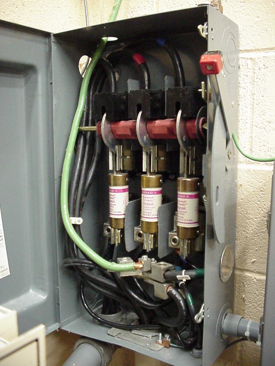

The fuses are all the same, but that's about the only thing correct in this switch...
File comment: Squirel caged stacked conductors with missing stands make great connections....???

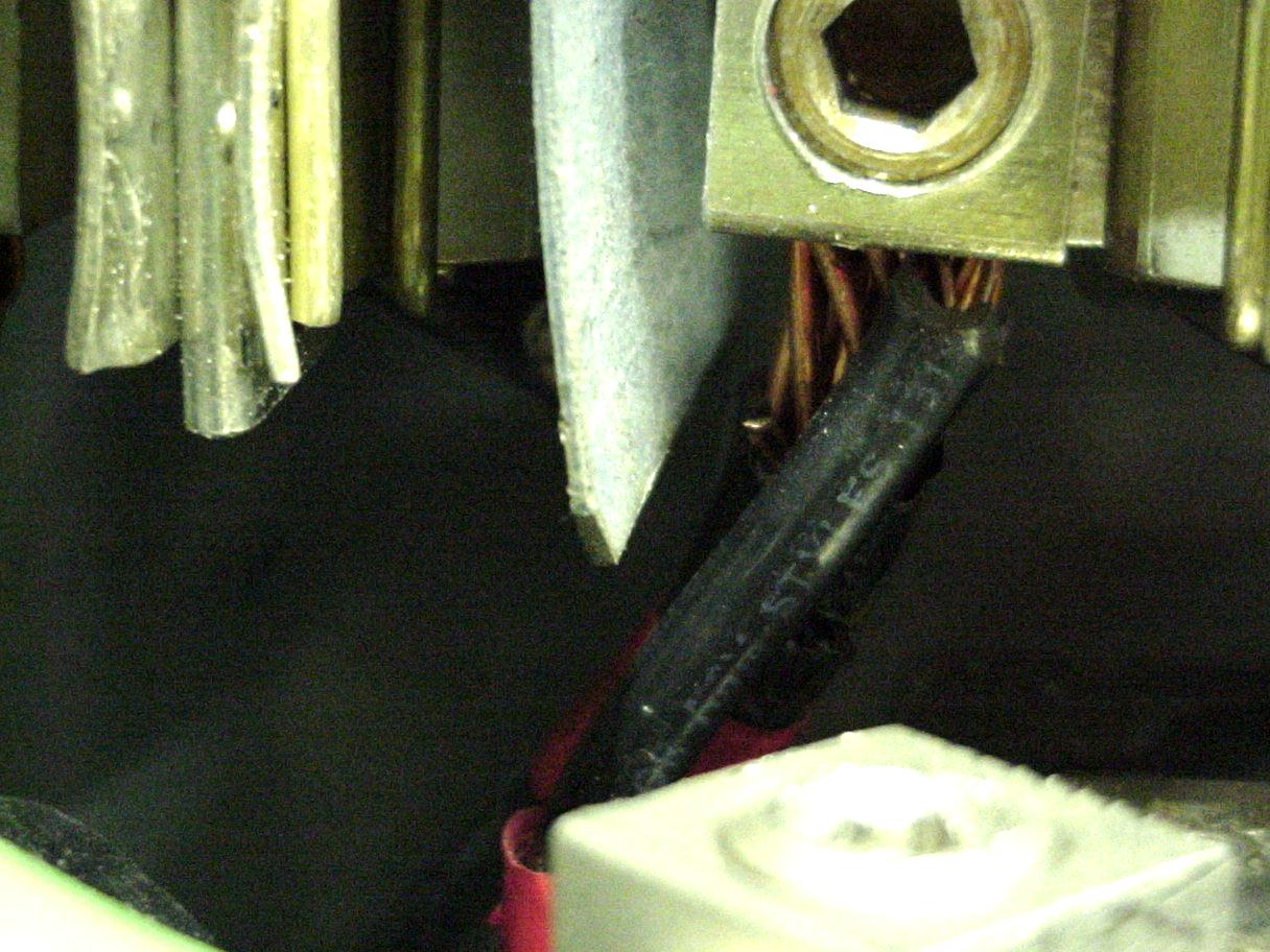

File comment: Its Ok to stuff multiple conductors into the same lug if the hole is big enough, right?

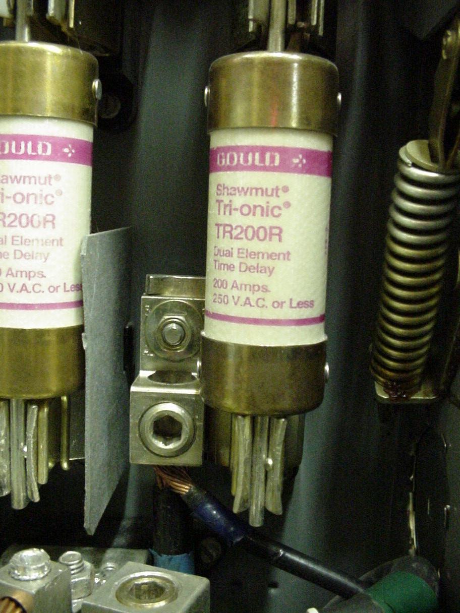

File comment: No clearance issues here...

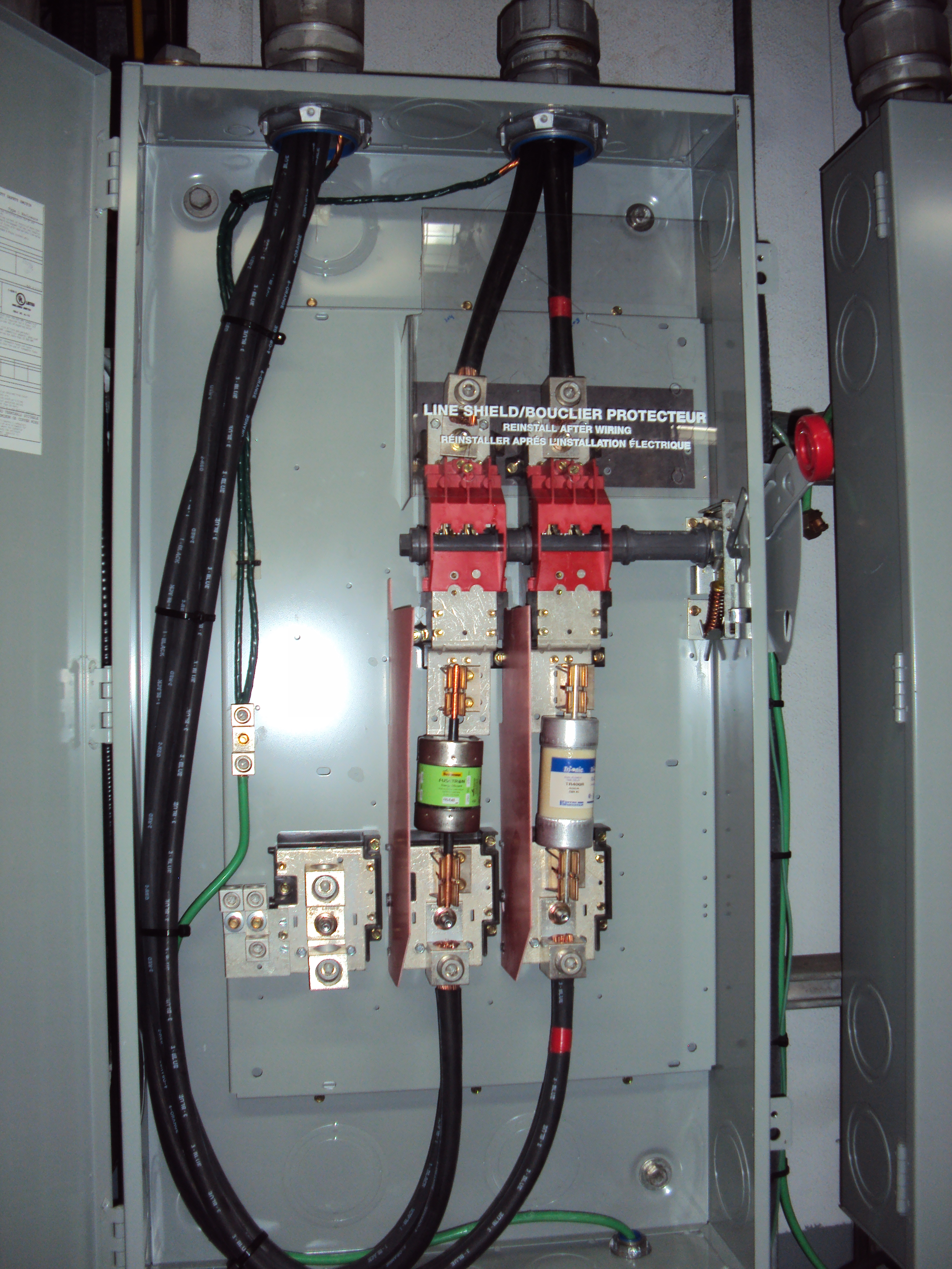

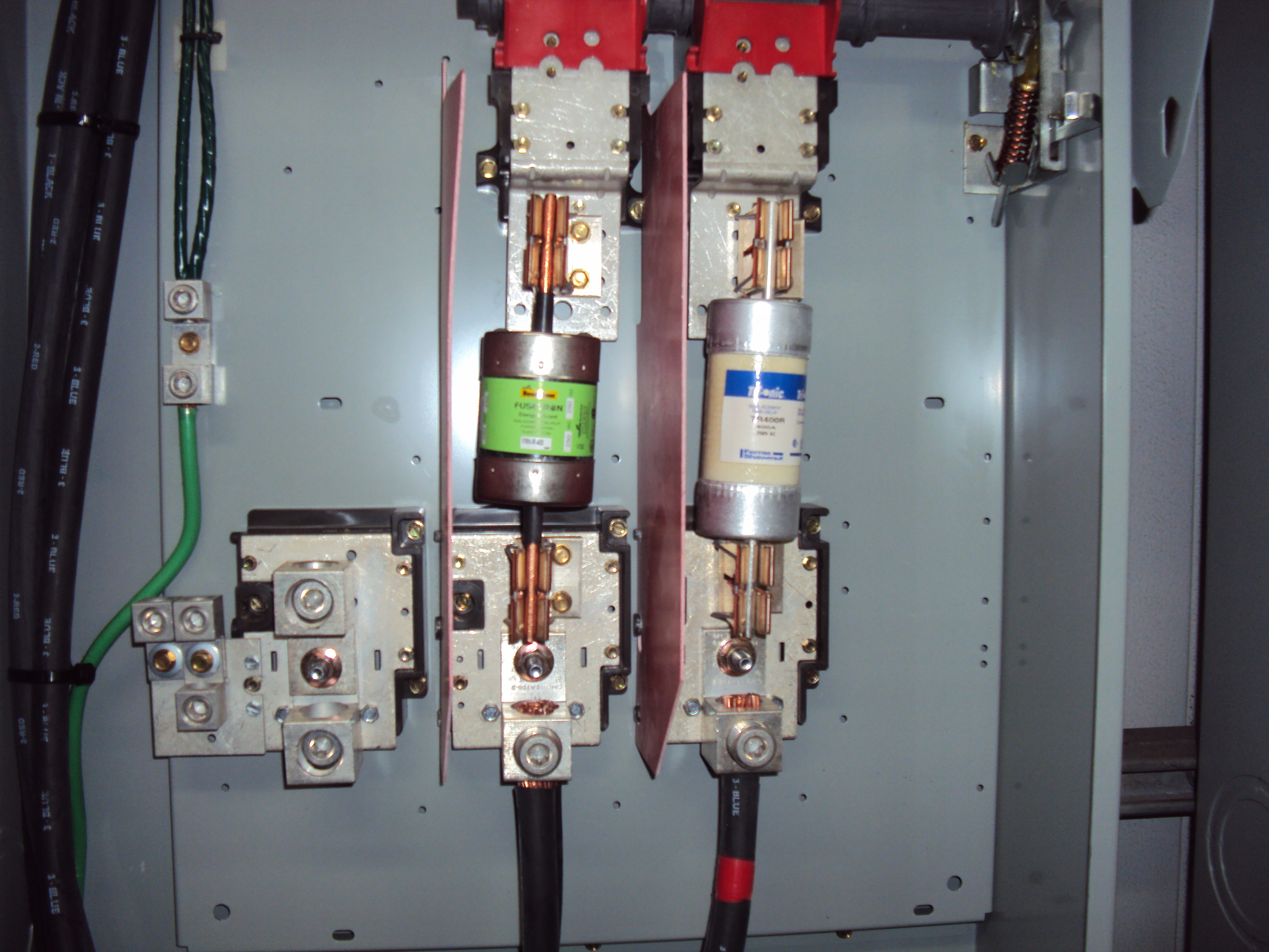

Flexible fuses?
This is a switch manufacturing error that no one caught. Do fuses maintain their rating when bent?

The bus bars on the end shouldn't be affected as long as the fuse body itself is not altered in the process of bolting it in.
How would you feel about taking the fuse and brazing bus bars directly onto it and bolting it in rather than using fuse clips? Horrified? Well...
https://www.monsterfuses.com/search/?s=55A212942P4RB
https://generalelectricfuses.com/ge-lim ... ter-fuses/
https://www.gescan.com/products/ge-55a212942p12rb-32078
GE does it in their Limitamp starters among others.
I'm not condoning the practice, just pointing out that manufacturers abuse fuses all the time, whether it's a design decision in engineering or a design change on the shop floor.

When performed correctly, soldering, silver soldering, or even brazing, should apply very little heat to the fuse elements.
In the photos above the fuse body on the left appeared a bit distorted.
To add further insult to injury, this disconnect, fused for 400-amps, was connected to 1000 amps of rectifer capacity. This system had two identical 400-amp fused disconnects, (the other disconnect didn't need bent fuses), connecting to separate 48VDC batteries on one side and a 1000 amp rectifier plant on the other side. After a battery discharge all the fuses will clear unless the DC load exceeds 200 amps. :o

I’m confused? It’s DC? If so not all fuses are tested for DC so there is always a selection problem. That might be the biggest TESTED size. Generally (RMS argument) the DC rating is about 50% of the name plate AC rating. Second sounds like redundancy if it’s not a max size issue by having two battery strings. A lot of utilities do it that way. If it’s all or nothing though then it is pointless. Often with DC fuses I see a lot of goofy, rare European brands with of course CE (not third party tested) marks.

The fuses in the 2 pole switches are DC rated.
The rectifier can produce 1000 amps. The normal system load was approximately 200 amps. Under normal conditions the charge current to each battery is a few hundred milliamps. When normal AC power fails the batteries discharge to support the connected load. When AC power returns the batteries will draw as much recharge current as the rectifier can produce. If all of the load is still running, and if each battery is identical, and each battery provided the same amount of energy during discharge, and the external circuit resistance of each battery is equal; then, each battery will draw 400 amps of recharge current. This has each fuse operating at 100% of rated current for some period of time during recharge. However, if everything isn’t equal, or if the load was reduced, or if one battery was off-line for some reason, the recharge current would exceed the fuse rating and the fuse would eventually open. How fast the fuse opened would depend upon the details of the specific event.
