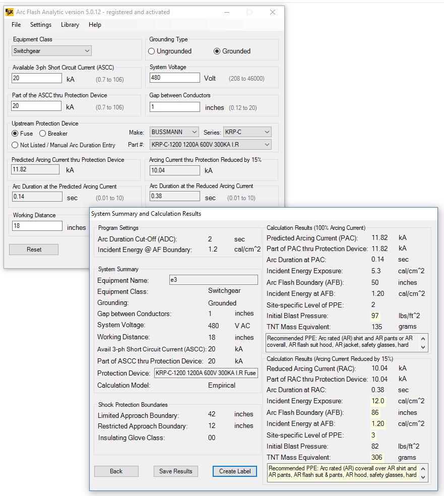

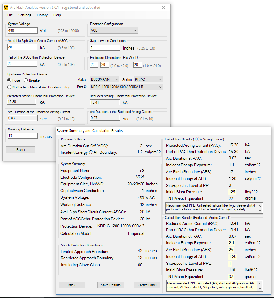

Spryduck wrote:
Are the results going to be significantly different? By "significantly" I mean raising or lowering IE values enough to have to change what PPE is worn.
Yes indeed the results could be way different. Screenshots below show calculation results for a similar system as predicted by IEEE 1584 - 2002 (Arc Flash Analytic version 5.0)
and by new IEEE 1584 - 2018 (Arc Flash Analytic version 6.0)

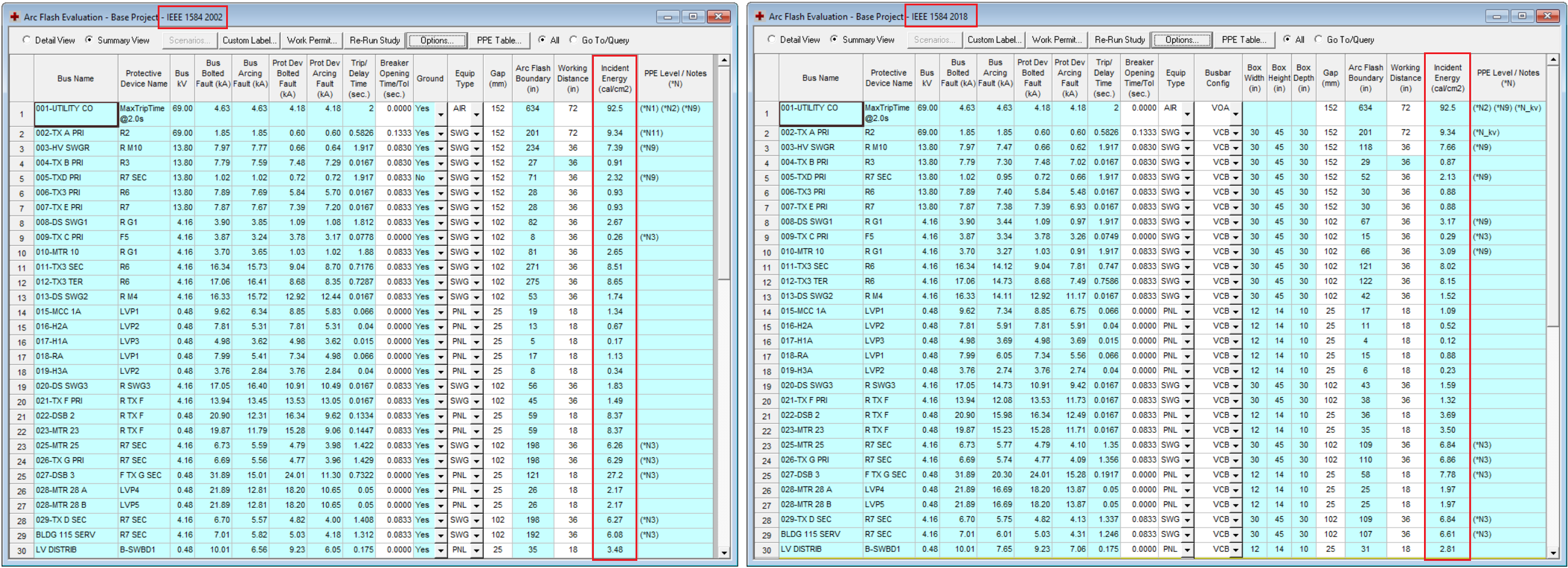

Here's a comparison between 1584 2002 vs 2018 on a sample project. Results are pretty similar, although typical box dimensions are used. YMMV.
