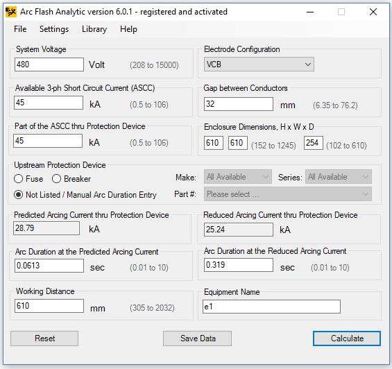

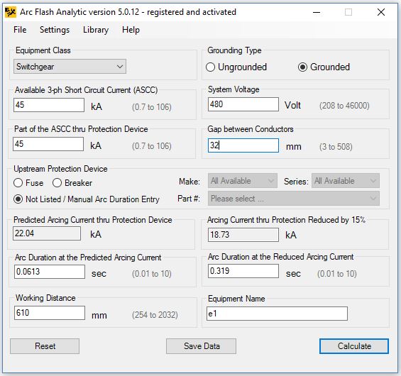

Shouldn't the options 1 and 2 be even considered since the old IEEE 1584 model has been superseded and it's not clear what is most conservative? Other than introducing enclosure dimensions, the new model doesn't require more information to perform the analysis (actually less information is required since grounding type was dropped and equipment class was traded for electrode configuration and enclosure size). Screenshots below show information required when using old IEEE 1584 year 2002 and new year 2018
IEEE 1584 year 2002 based arc flash analysis inputs
upcoming IEEE 1584 year 2018 based arc flash analysis inputs

The enclosure size can be modeled with more specific size detail - will people determine this since most don't determine the gap and use defaults. That is what some of this is about.
The electrode configuration can have an effect as well. 2002 used vertical electrodes and the next edition also has this option. However there are other options such as horizontal and vertical terminating into an insulating barrier. This is all a bit hypothetical at this point since the final edition standard has not been published yet and new software has not been released (that I know of) Just trying to gauge the feel of those that perform studies.
