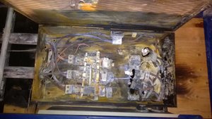

The facility was trying to do the correct thing with Thermography scans. Except this box could not be worked on unless the utility company removed power to the facility. This feel through the cracks and ~6 month's later, we had an incident. Other than the box and the plywood it was mounted to, no significant building damage.
