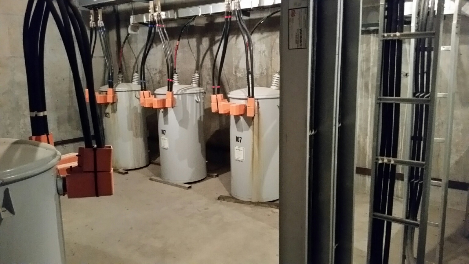

I will also add, in some of our problem areas it is because instead of the usual green oil filled pad mounted transformer with 5%-ish impedence feeding the building we have in a few instances 3 single phase oil filled cans wired for 3 phase and the cans only have 1.6-ish% impedence allowing higher fault currents on the secondary.
