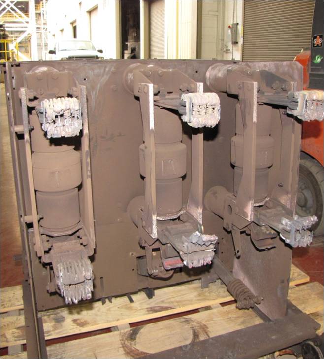

Pictures of unattended switchgear, maintenance testing and inspections are important. This is what an arc flash looks like befopre it happens.

What was the analysis of the failure?

Are you actually seeing non-intrusive pd survey's being performed during routine inspections or on a scheduled basis? I've honestly never heard of that technology. It would certainly be nice to not wait until you walk into an aisle way of some switch gear to the aroma of ozone and the sizzling of tracking.
I've actually spent the last few days disassembling the cross-over bus of some old ABB switch gear and hi-potting to find the problem areas. Thankfully, it was caught early enough to jumper the line and shut the position and bus down to perform the work.
