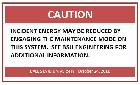

I'm currently thinking about adding a label like this to the equipment affected by the maintenance mode switch instead of having 2 values.

I like "Arcad" suggestion above whether it be one label or two labels installed side- by side perhaps. Of course this has to be coupled with training and part of the overall workplace electrical safety program. The worker must understand what ARMS On and ARMS off means. I have found too many times where the company has gone to the expense of having the AFRA done and then do not train the workforce- end result is no one knows how to read or interpret the label

I am a far bigger fan of the combined label, rather than two otherwise identical labels side by side.

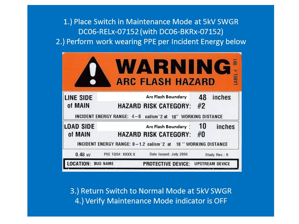

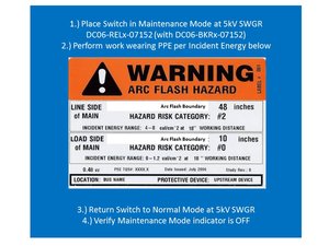

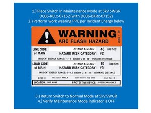

We developed a simple blue phenolic backdrops to affix the AMRS label. It includes simple directions to staff on where to go for the ARMS switch, (the current label depicted in my example, is not from a real location).
The non-ARMS label is posted adjacent to the ARMS plate, so staff are aware of our 'worst case' IE.

I like the backdrop idea suggested by Charles Aycock and the label by bbaumer, to notify employees that the maintenance switch exist on the circuit breaker feeding the equipment. Often the label will be on a downstream device, far away from the switchgear which has the RELT breaker installed. The backdrop would be a great place to tell the worker where the breaker is located in the facility.

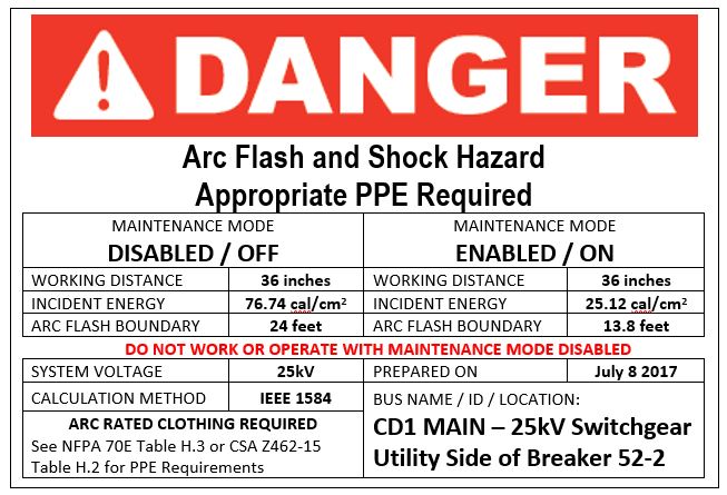

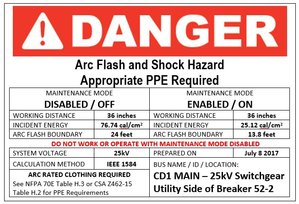

first time poster.
just wanted to say that this thread has been really helpful. great ideas suggested here. what really surprises me is how objective the NFPA70E requirements are, and yet how subjective the interpretations can be....
i've tried my first stab at labels for my project, similar situation where incident energies are drastically high but implementation of a maintenance switch lowers it to manageable levels.
see attached screenshot.
File comment: arc flash label w- maintenance mode

I notice the examples above span the range from "caution" to "danger". https://en.wikipedia.org/wiki/Precautionary_statement
I would submit that warning signs are most appropriate here.
 Post subject: Re: RELT or ARM Arc Flash Labels
PostPosted: Sat Jul 08, 2017 6:59 am
The signal word for "helpful instructions" by the way is NOTICE and the appropriate color as per ANSI Z535 is blue.
So Arcad's "Caution" isn't really the correct word or coloring but the content is the right idea. Since typically you see a whole lot of red, orange, and yellow, blue actually stands out.
