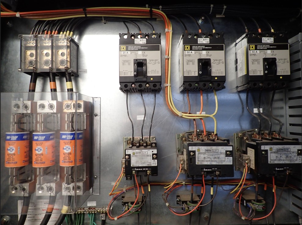

A side note, I have noticed that oftentimes control panels will have Class J fuses at their input terminals. I don't know if that is mostly to get a higher withstand rating for the panel or to reduce incident energy or both. For example:

I have never cared for calculating AFIE at different points within a control cabinet, unless it is very large with multiple doors. In my opinion this is similar to not calculating AFIE at multiple points within a circuit breaker panel or switchboard. There are too many variables to consider as far as the arc propagation.
My experience has been, current limiting fuses are used in control panels to comply with the SCCR procedures in UL 508A.The fact these fuses could have a possible benefit for AFIE is purely coincidental. The majority of customers have wanted the panels labeled with the arc values at the incoming lugs.

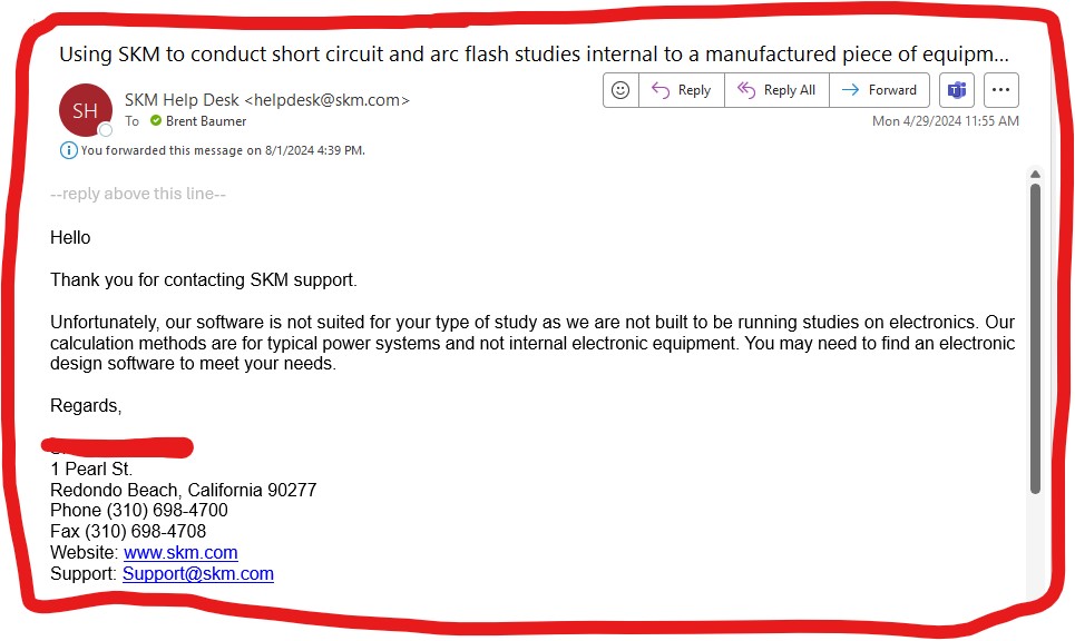

I mentioned in the video that I had asked SKM about using PTW to model the "guts" of a piece of equipment. It was basically power electronics but had terminal blocks, fuse blocks, tap conductors of different gauges, relays etc. similar to a industrial control panel but not exactly. I suspect the answer would be similar if I asked them about modeling the "guts" of a control panel but admittedly I have not tried. Here is the response I got back:
