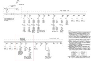

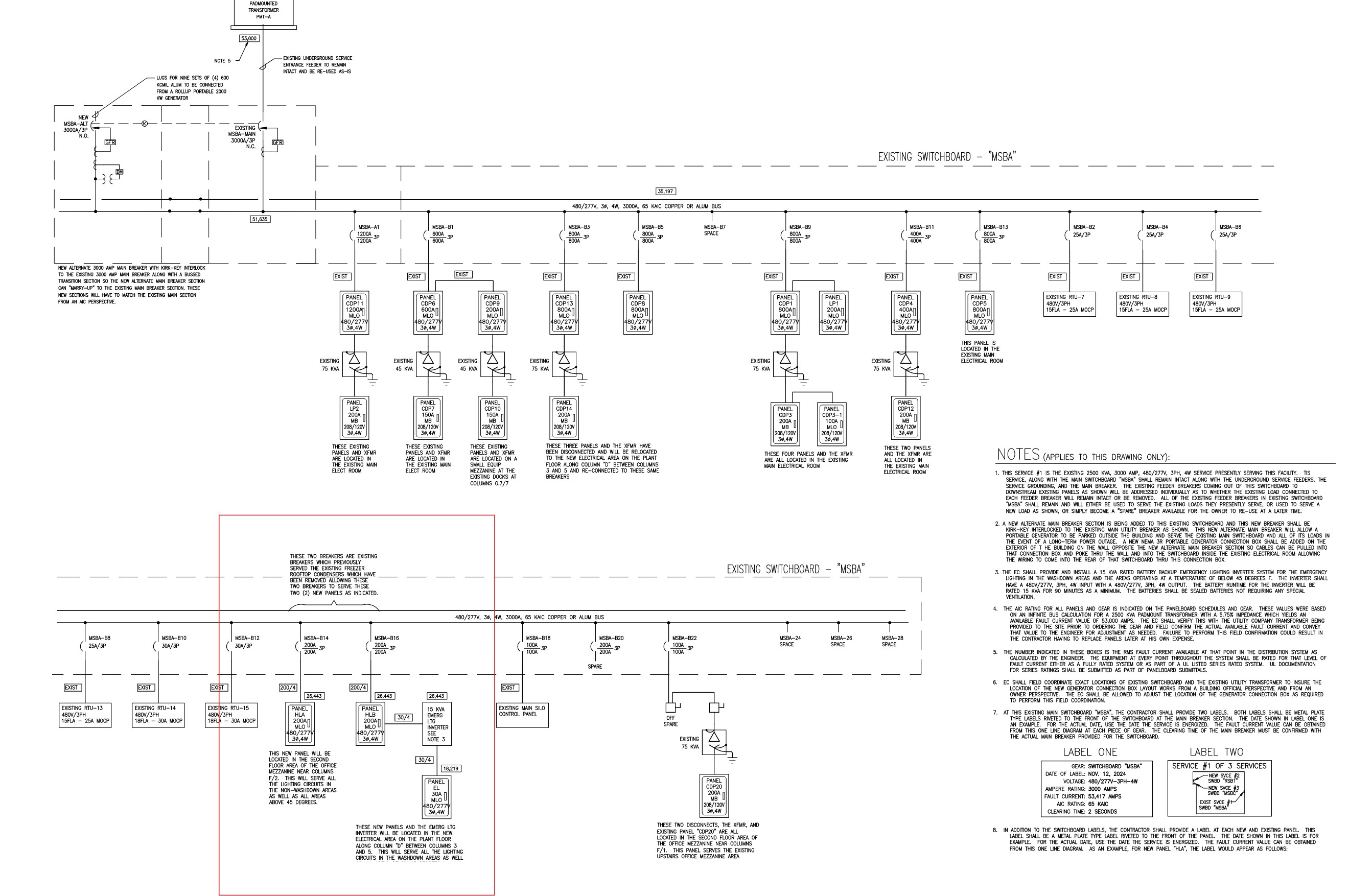

I was asked to provide labels on the new equipment that was installed.
I have the utility details, MSBA details and I have the panel details. Do I need to model the whole Switchboard in SKM or can I just model the Utility, MSBA- Main breaker, MSBA and the two new equipment?

I agree with Mike's assessment. That is a small system and wouldn't take long to model. The time consuming part will be getting all the data.
