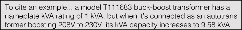

I'm asking because Buck-Boost Transformers operate as an autotransformer, and can supply a load much larger than its nameplate suggests. See example from ACME (Hubbell) website http://www.delzer.com/hubbell/acme_cat/#122/z on page 122. Buck-Boosts can be up to 10KVA+ in size, and could potentially supply a load of 200KVA, depending on voltage.
Buck-Boost Transformers ARE THE SAME as an isolation transformer, just with terminal connected in a different order. So if you observe a 10KVA transformer on a branch circuit, you might ignore it. But if that is supplying a 100KVA load at 240V, it would be a mistake to overlook that since you would have 240A of load.
My inclination is to ignore the transformer, and treat the circuit as continuous from OCPD to load. But I know in the event of a fault, the primary windings can saturate which limits the amount of current that can get through to the secondary. I'm interested to hear everyone's thoughts!

100KVA three phase 240V load. 100KVA / 240V / 1.732 *1000 = 240.56A, single phase would be even higher, 417A.
VA is conserved so VA in is equal to VA out plus loss.
True, VA is conserved, but it will not match the VA listed on the nameplate. See the attached picture in first comment or follow the link. It is not unusual for a BB Xfmr to supply a load 10x the nameplate rating, depending on the turns ratio.

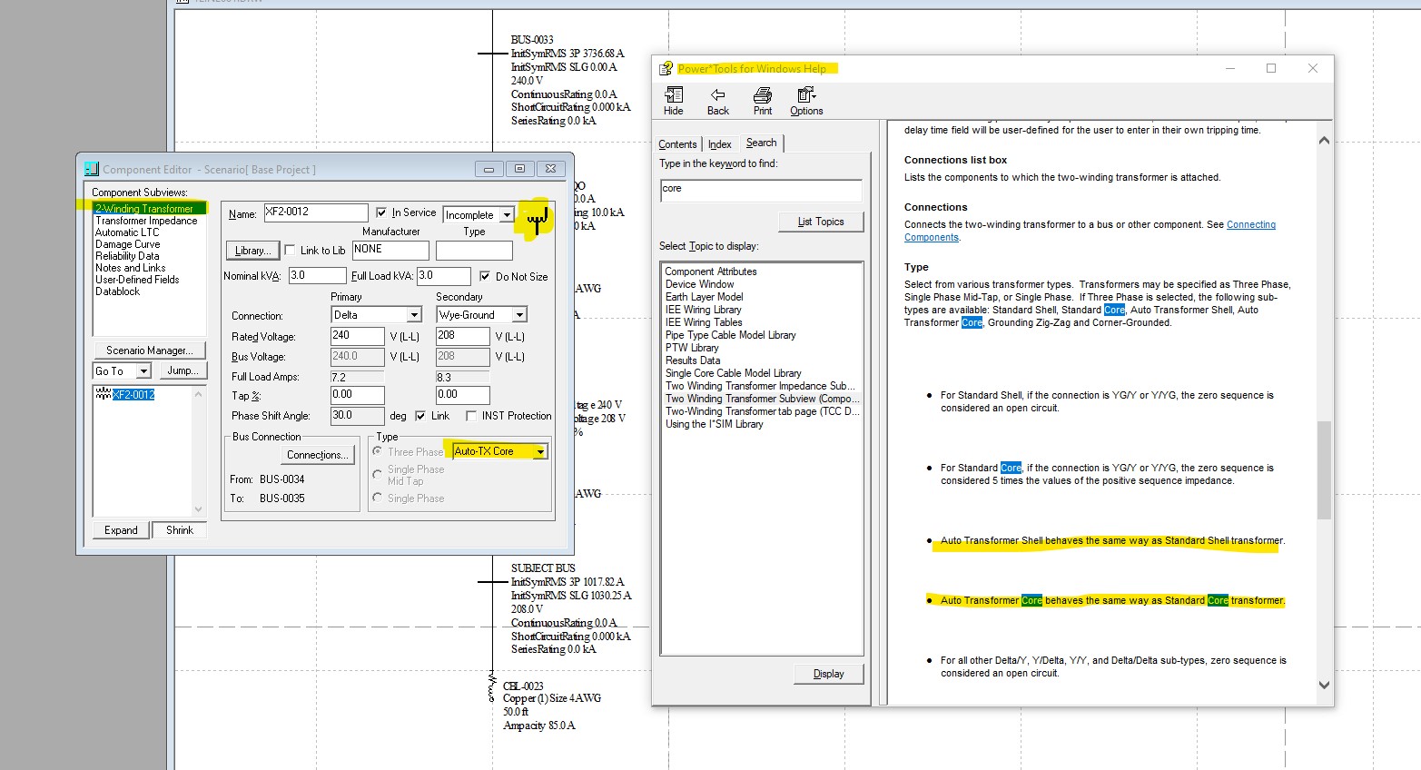

Agreed. But the fault at the secondary is not completely limited by xfmr impedance like it is in an iso-xfmr, because the secondary is wired directly to the primary. So modeling with an iso-xfmr would be incorrect.
SKM Power Tools has a TYPE option in the Component Editor where you can select "Auto-TX Shell" or "Auto-TX Core" but it doesn't seem to do anything. I don't see another way of adding an Auto-Xfmr. Can ETAP or Easy Power do this?

I think you're right that changing the connection type in SKM to Auto-TX Core doesn't do anything. Here's what SKM Help says on it:

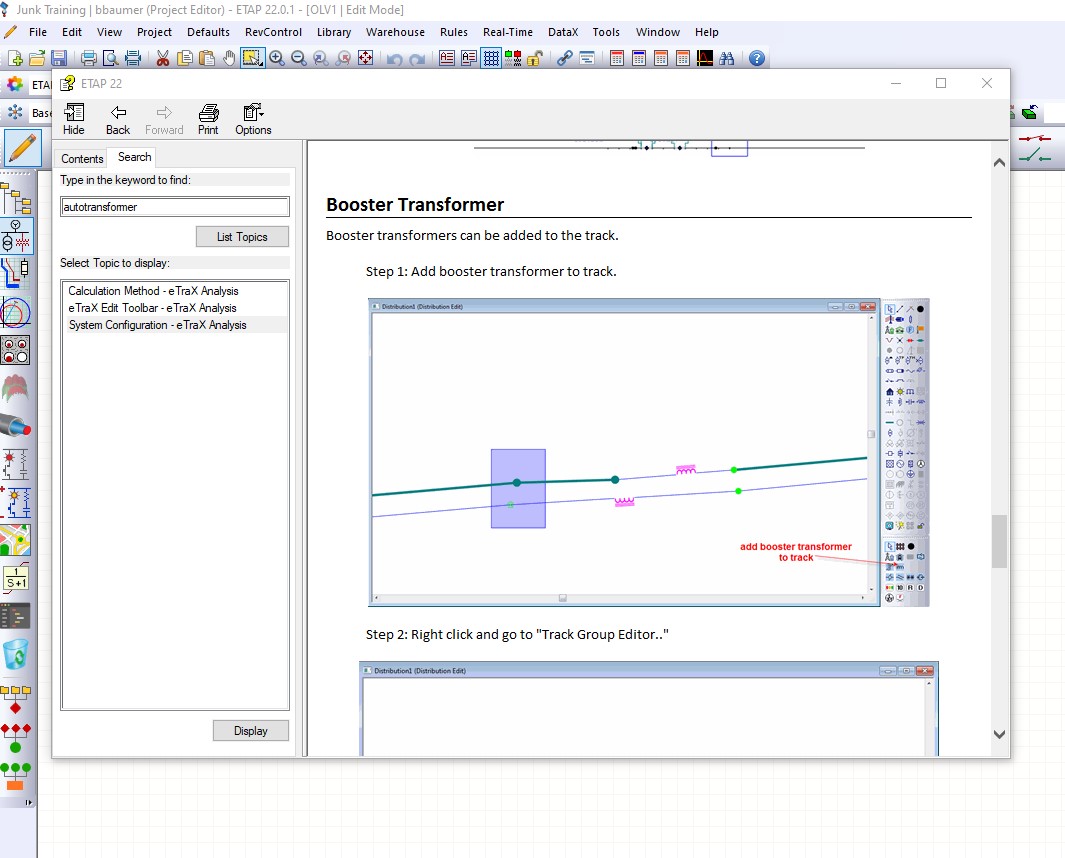

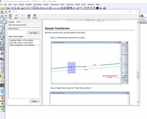

I don't know about EasyPower but I did a Help search in ETAP after I could not find that option to add an autotransformer or buck-boost in ETAP and it came back with this, among other things:
That said, my experience level with ETAP isn't nearly what it is with SKM and I have not used whatever modeling method or operation ETAP is referring t there. If you have ETAP maybe you can do a similar search and get your answers.

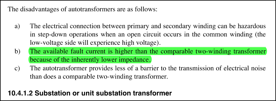

Thanks for looking into it and the info. I happened to stumble across this in the IEEE Std-141 Red Book, Chapter 10 section 10.4 for completely different reasons.

BarkFlash wrote:
I will also add that I do not have the single phase module in SKM so I could not check to see if auto-transformer or buck-boost is an option in SKM if you have the single phase module. As far as I know there isn't such a thing as a 3 phase buck-boost transformer. You have to use 2 or 3 of them wired for 3 phase but I could be wrong there. Maybe you could use three single phase autotransformers wired together in the model if you have the single phase module. Not sure.
I did notice that in ETAP when I was looking at transformer attributes it does give you the option to model a three-phase transformer as 3 individual single phase cans wired for 3 phase like you'd commonly see on pole tops and sometimes in vaults.
Thanks for sharing that info.
