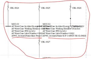

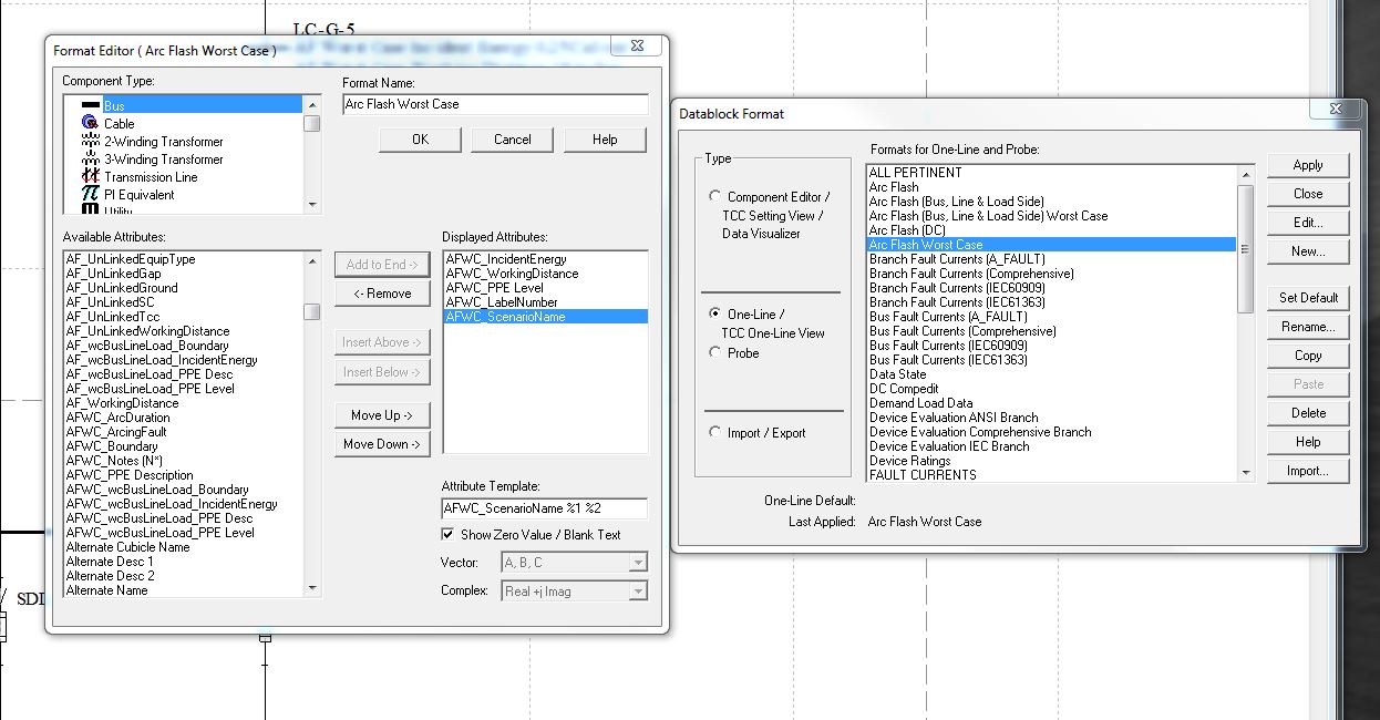

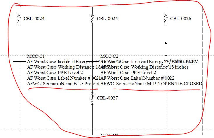

 Post subject: Re: utility fault contributions
PostPosted: Tue Jun 18, 2019 4:23 am
GaryPC wrote:
Did you find a Datablock Format Attribute that has the worst case? I'd be interested to see how it reports it, and does it state which scenario. This would be good to find for example when the scenario is emergency system transfer switch position E versus N.
You can edit the arc flash worst case datablock and add the scenario name in the editor.
