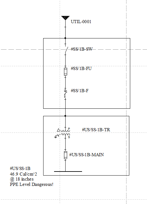

Hello all, first time poster here. I am working on an arc flash analysis for a client using SKM power tools. There are a few instances in which I believe I'm getting artificially high IE values. It seems that SKM "cuts off" the over-current device's trip curve right at the available fault current at that device. As a result, the tripping time is maxed out at 2 seconds (when I believe the trip time should be much less).
Does anyone else have experience with this?

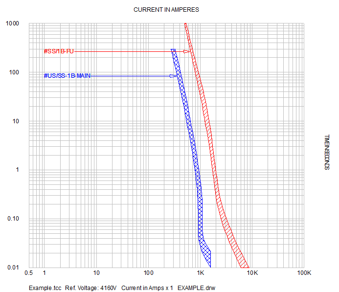

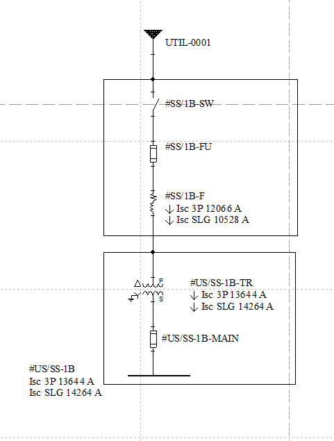

The available fault current at the OCPD is just over 13kA. From the TCC, I would say the trip time for the OCPD is approximately .0225 S (so significantly less than 2 S).
Included are three images: A one-line showing available fault currents, a one-line showing incident energies, and a TCC diagram of the two OCPD's.

1. Is the 13644A Isc 3P referenced to the primary or the secondary of transformer #US/SS-1B-TR?
2. Looking at the TCC it looks like SKM thinks the available fault current at #US/SS-1B-MAIN is less than 1.1kA at 4160V. That's where the blue curve cuts off abruptly. The arcing fault will always be less than the available fault current due to the resistance of the arc itself, so the arcing fault current should be less than 1.1kA referenced to 4160V. If you double click on the blue curve there is a set of options called "SC Flag and Termination Options" under "Flags" tab. I'm guessing "Maximum Fault Level" is selected. You can choose "Do Not Terminate Curve..." to see the entire curve, but again, everything above the maximum fault is irrelevant because it won't be possible to have any fault (arcing or bolted) level higher than that (theoretically).
3. Also in the TCC options if you click on the blue curve, under the "Arcing Fault and UD Flags" tab you can check the "Show Arcing Fault Current for Worst Case Incident Energy" and select the buss you're analyzing. If no lines show up then that device is not the one which is actually interrupting the arc. Check and see if you're considering the Protective Device Line Side value, in which case the upstream (red) device will actually be interrupting an arcing fault.

It looks like the TCC is at 4.16 kV, the primary voltage. The low side fuse (480V?) is shown at primary current levels and that is why the cutoff is so low. It also looks like the IE is calculated on the source side of the secondary fuse, with the fuse operating time over 2 seconds. IE on the load side of the secondary fuse would be based on the 0.02 sec fuse clearing time and would be much lower.
