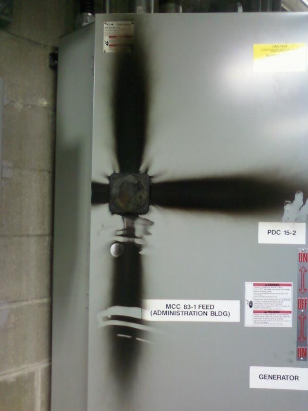

PostPosted: Mon Oct 12, 2009 1:42 pm
Posts: 1103
Closed doors, good solidly built ABB metal clad gear.
PostPosted: Mon Oct 12, 2009 1:44 pm
Posts: 1103
Closed door, 13.8kV switch, only HRC 2 per the tables with doors closed.
I can do this all day, I see this stuff everyday. I don;t care who intreprets what how, or if a FPN is enforceable or not, unless it is arc rated, switchgear can not be relied on to contain an arc flash.

Zog,
I have personal experience with exploding switchgear: both arc resistant and non-arc resistant. Sometimes the doors blow off, sometimes the bolts are stretched and the doors stay on, sometimes whole sections of the gear are just melted away in unexpected places. It's totally unpredictable. The arc resistant stuff is much better in handling the flash but there's still a flash and the energy still goes somewhere. What is safest is not the issue I'm trying to understand.
I'm trying to determine what are the rules as prescribed in the 70E document and by the committee. We can always choose to go beyond the requirements. But many times it has been said that the rules apply closed door as if it were a requirement of the code and I'm not so sure that's the case. That's what I'm trying to get to.
