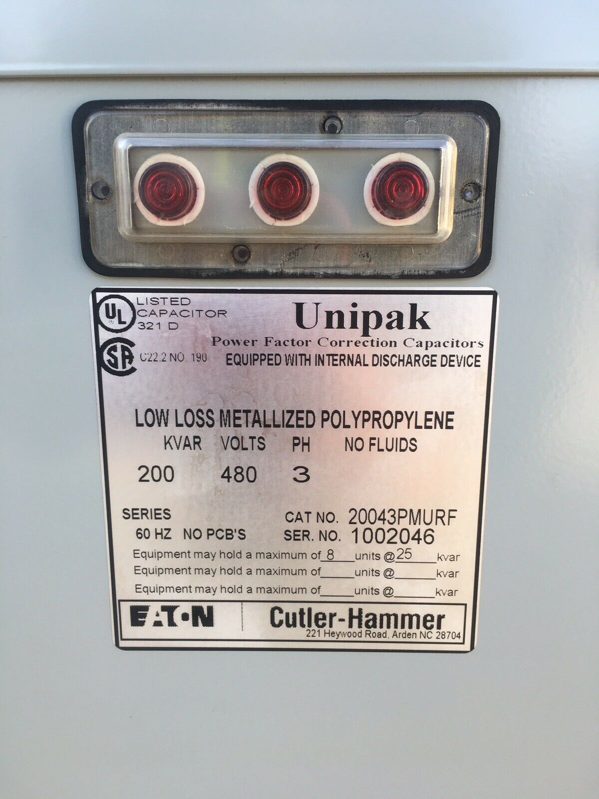

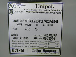

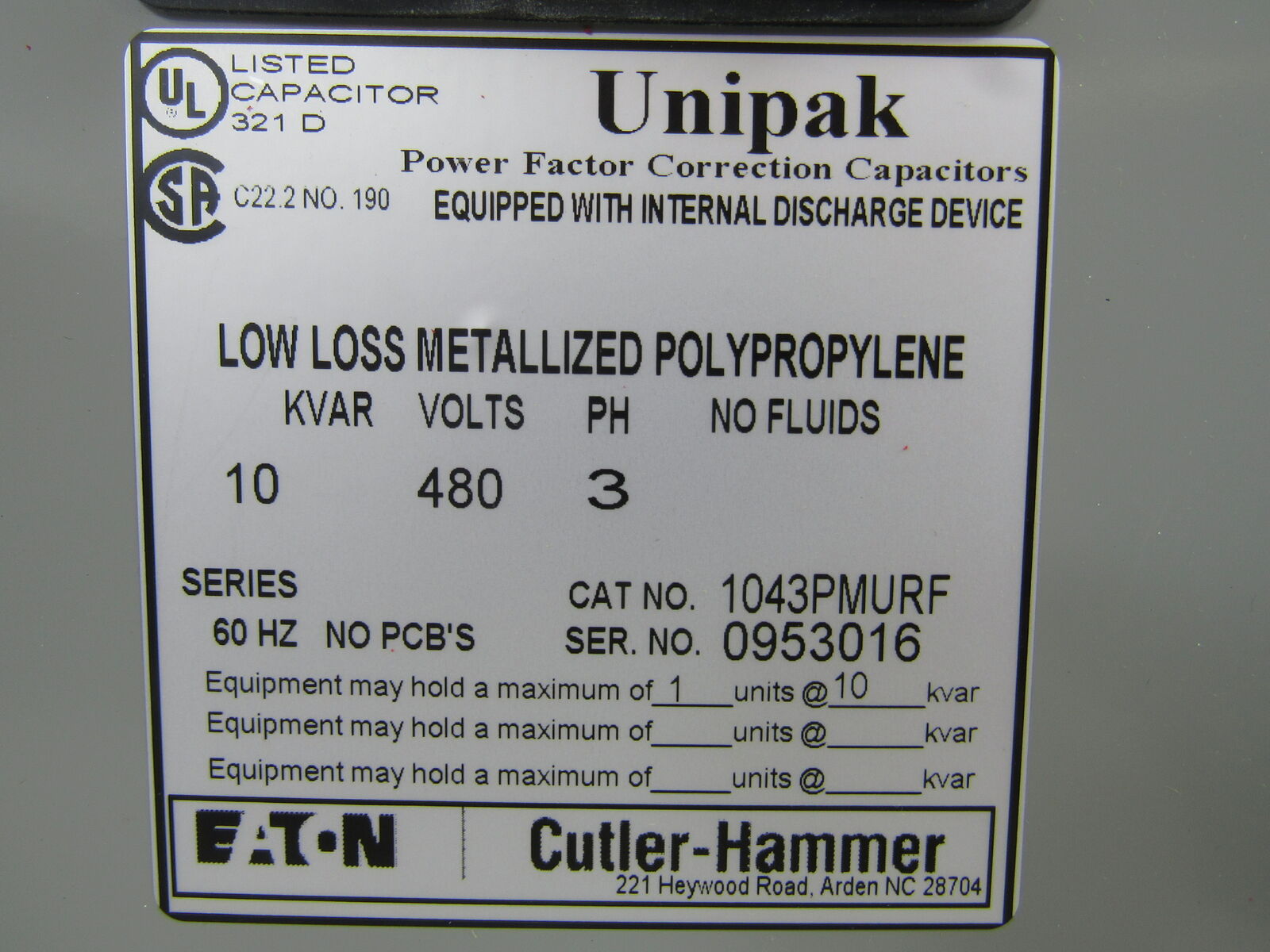

Now if the equations above using the following sample nameplate data:
10 kVar @ 480 Volts for a 3Ph bank.
Xc= (0.480)^2 / (10kVar/1000) = 23.04 ohms
Therefore Capcitance= 1/ (Xc*2*pi*60) =0.000115129 Farads or 115.129 uF
Are the results above the per phase or the total 3-Ph reactance and capacitance of the bank?

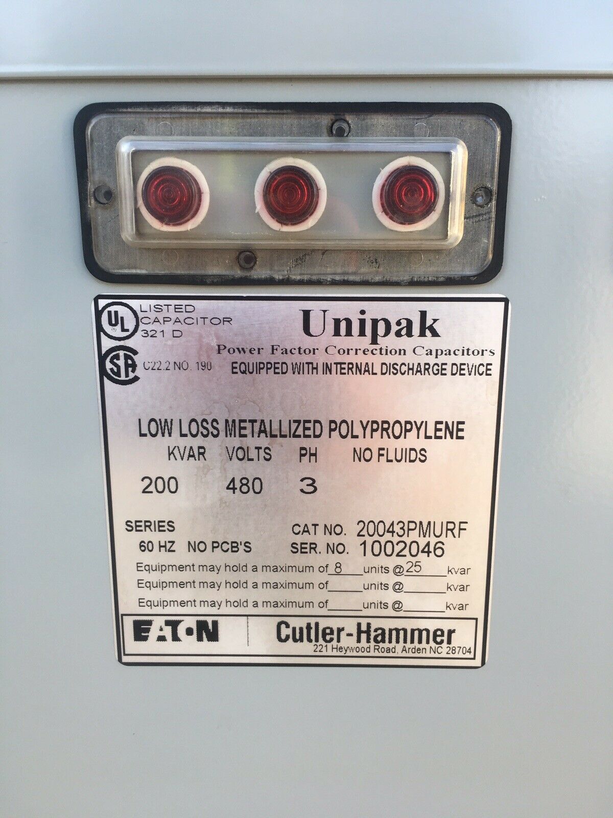

Also how would the calculation above change for a bank made up of multiple capacitors?
For example in the case below where 8 capacitors make up the capaitor bank.
