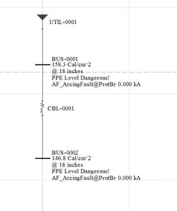

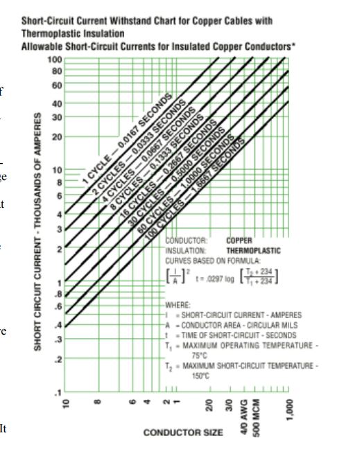

Thanks Paul.
I referenced withstand rating along your same line of thinking, I think.

The equations and curves posted above are for conductor damage. I am unaware of any approved methods for determining the clearing time of a #14 copper wire. Remember also that where arc flash testing is performed, arcs are generally initiated with a fine conductor that completely vaporizes without interrupting the fault.
I disagree with the statement the wire is unprotected since it is ahead of the main. The utility will have protection, even if it's on the primary side with very long clearing times. If this time exceeds two seconds, then cut it off at two seconds per IEEE.
If you are looking at this from the utility side, the NESC has a low voltage table that deals with the IE question. The table is based on testing.
In the arrester example, the utility is likely to have an upstream recloser or reclosing circuit breaker that will give the arc some time to dissipate after the wire separates.
Do not use the method you propose, it is not supportable.

By my definition, low voltage includes anything at or below 1000V. Bbaumer's figures show he is not below 300, but is operating at 480V. 480 V will sustain an arc easily.
Conductors are not fuses, they were not designed or intended to interrupt faults.
