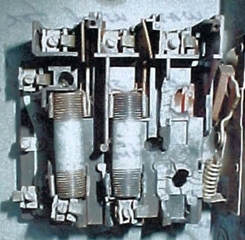

This equipment was used on a mobile home site and led to a fire that killed the occupants in their home!
File comment: No blow “conduit” fuses,

:shock: I'm going to ask SKM for the TCC curves on those on Monday to add to my device library.
Seriously though, sad story and totally preventable.
