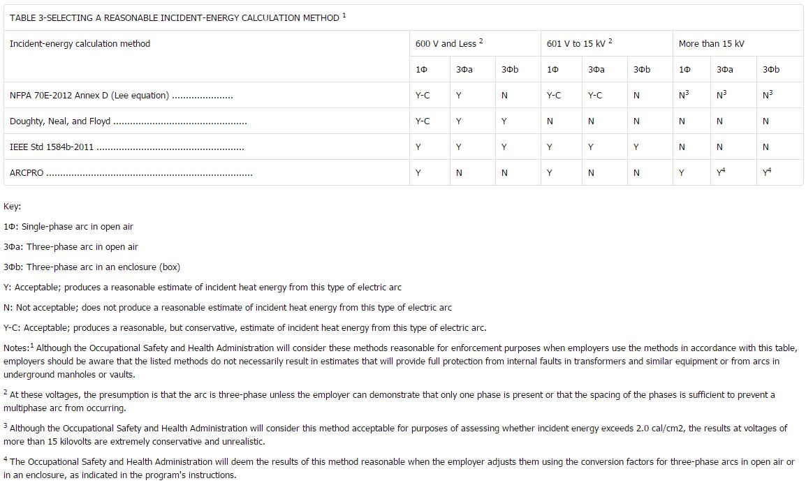

Hi,
I am wondering if anyone else is experiencing delays in receiving ARCPRO software? It has been 6+ weeks since our order was placed, and Kinectrics will not provide an update on delivery. At the time of quote, I was told 4-6 weeks.
My understanding is the supplier in the USA is HD Electric, and in Canada the supplier is Young Utility Equipment. Both suppliers have said that the software comes from Kinectrics, so whether our US office purchase from HD electric or the Canadian office purchases from Young Utility, the delivery would be the same (4-6 weeks)
We need ARCPRO to comply with OSHA 1910.269 table 3 for calculations above 15kV....but that is difficult without the software being made available to customers willing to buy it.
Thanks,

When I bought it thru HD, it took awhile and then it took awhile to get a passcode. Here is HD info to me on that.
When the ArcPro is ordered, HD Electric will ship a CD. This CD cannot be used until the registration has been done and Kinectrics provides you with the password to activate the software.
Here is what I got when waiting for a password:
Per HD Electric the standard time to provide the file and password to use the software after Kinectrics receives the completed registration form is 3-4 weeks. I am not sure how clear this is made.
It is designed to run on Windows XP, so you will that or an emulator. Below is what I received from HD in 2013.
ArcPro 2.01 operates with Windows 7. The program however requires an actual or emulated 8, 16 or 32 bit processor (as opposed to 64).
If your machine has only a 64 bit processor you can:
- On Windows 7 Professional – run the computer temporarily in XP mode by downloading a free conversion on the internet
- Load Virtual M ie VM which allows you to run the machine in any version of Windows including those that emulate 32 bit machines
You can load ArcPro on an older machine that has a 32 bit processor

Probably reverts to Lee at 15 kV if it even goes that high. As OSHA noted, Lee gives extremely conservative results at higher voltage. ArcPro is the only reasonable show around for 15 kV and higher.

It all sounds good except for the fact that there isn't any test data above that voltage. So OSHA's "analysis" is that Lee gave very high results, and Duke heat flux gave very low results, and ArcPro was right down the middle.

The issue becomes if you are trying to meet OSHA 1910.269 for making a reasonable assessment of incident energy for electric utilities. OSHA provides a table in Appendix E which lists what OSHA considers as methods which provide reasonable estimates of IE and the only method listed for >15kV is ArcPro. OSHA would probably accept another method, such as ARCMASTER, if there is documentation showing the two methods are comparable. So, IMHO one might as well use ArcPro and save a headache of trying to prove to OSHA the other method is equivalent.

Thank you for all your comments regarding other software options, but OSHA will only accept ARCPRO over 15kV as per Table 3 in the first post of this thread.
I have used ETAP for the rest of the facility with no issues. I also used ETAP for the calculation above 15kV (Ralph Lee Theoretical Calculations), but according to OSHA Table 3 this is overly conservative and is not acceptable. See note 3 of Table 3.
