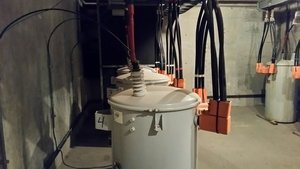

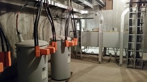

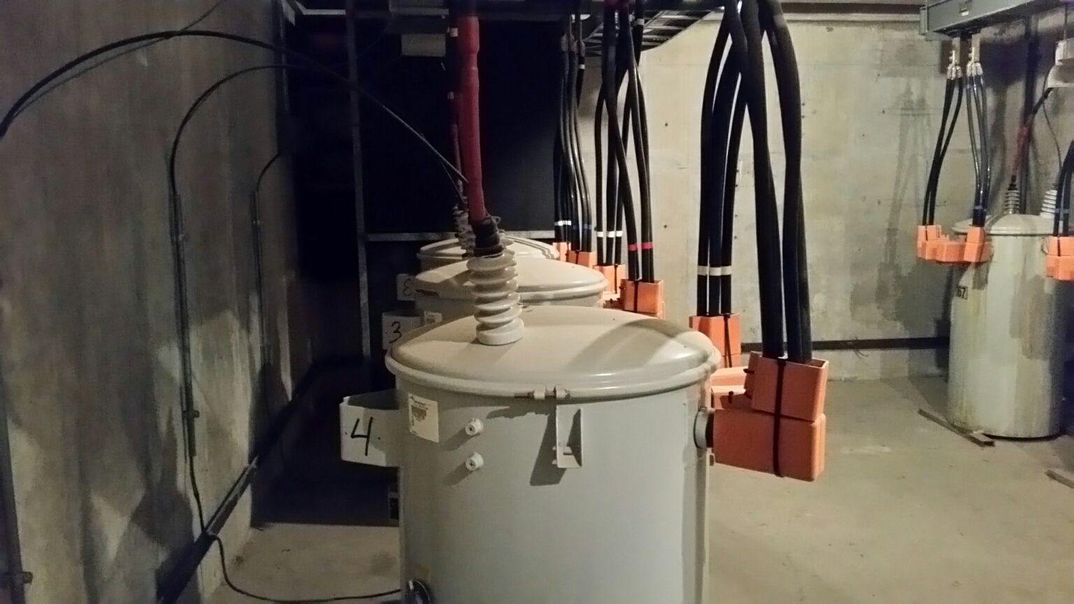

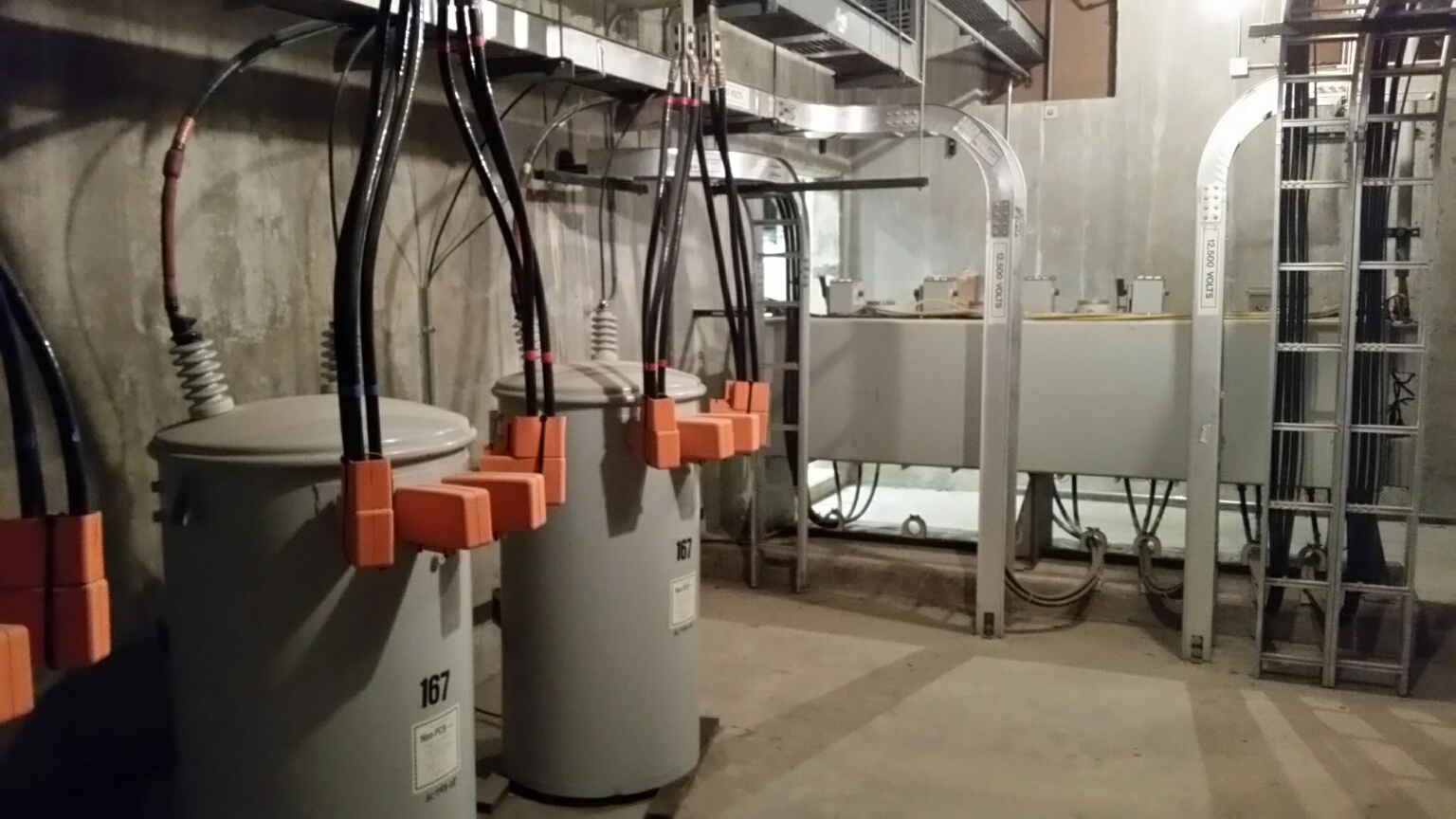

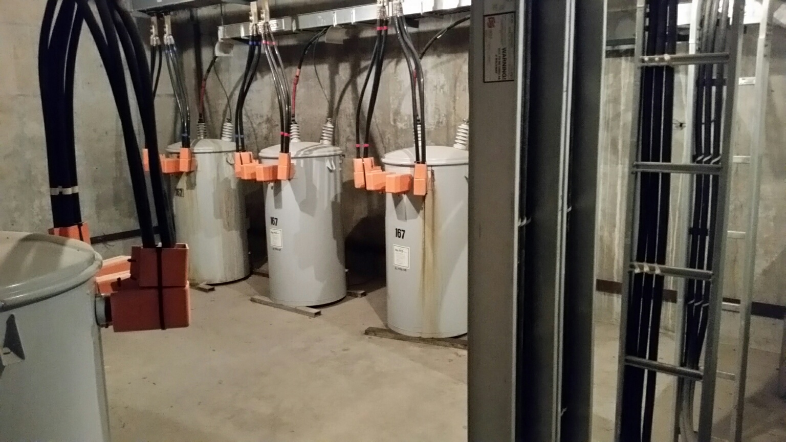

We have a handful of old installations on campus using single phase oil filled cans to make three phase power like you see in the pics below. We put the orange rubber boots over the paddles several years ago. In recent years we've determined in most cases we cannot open the doors on our pad mounted transformers while energized due to too high of incident energy. We discussed installing rubber boots on the paddles like you see in the pics below on our pad mounts too.
In your opinion, would doing this eliminate exposure to live parts?
We have over time converted most of our pad mount to external oil sample ports and drains so we can now take samples without opening the doors and we buy new transformers with the external drain but you still cannot see the gauges or see if you have a spare conduit or how feasible it is to add another feeder etc.
Thoughts?

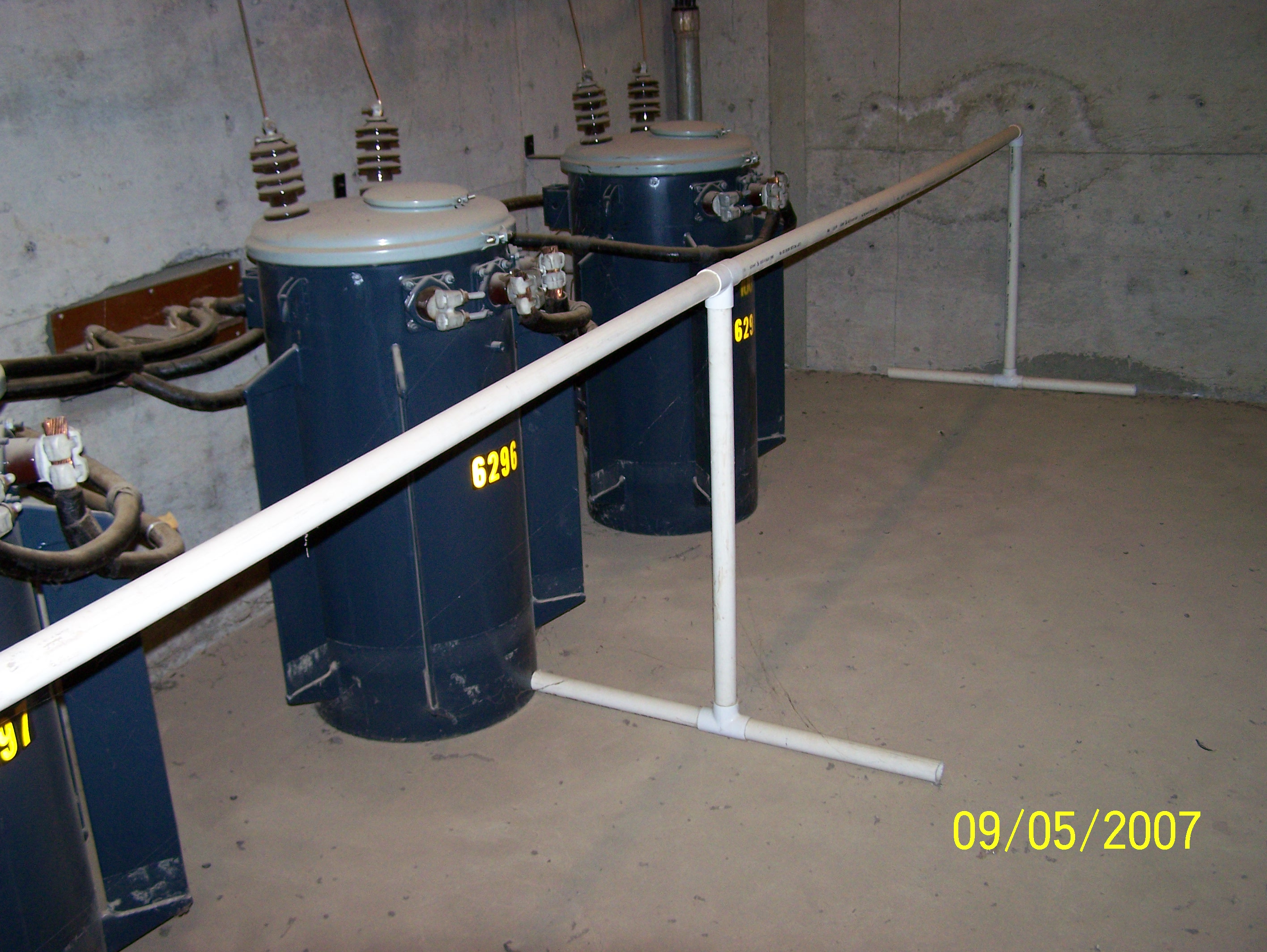

Here's a photo of an inadequate, easily moved secondary guard. I understand the janitor was given a key so he could mop up after the rain blew in through the door vent. All gone now.

The rubber boots will help protect against inadvertent shock and could prevent an arc flash event.
The item I don't understand is your statement
How was the determination made? What voltage are the secondaries of the padmount transformers? NESC Table 410-1 lists padmount transformers as 4 cal/cm2 up to 600V and 601V to 1000V as 6 cal/cm2. IMO that is not too high of incident energy as PPE is readily available and utilities open many padmount secondary doors with no incidents.
I do like that you are ordering the transformers with sampling ports that are accessible from the outside.

My pics are to show the boots, not the pad mounts install I'm asking about. Oh, and in the pics the primary bushings are insulated. You can open the door to the secondary side of a pad mount without opening the primary side door. Have no idea what you are talking about.
I'll have to look into the NESC section you cite. Arc flash analysis yields much higher than 4 cals on the secondary usually. I have witnessed a secondary L-G fault on a pad mount secondary with my own two eyes that did not clear the primary protection. It did not clear until we reopened the primary feeder switch.
Oh, and we have 480Y/277, 208Y/120 and 240V delta pad mounts. All primaries are 12,470V delta.
Where we still have single phase cans they are in vaults behind 2 locked doors. The first door is into a mechanical or electrical room accessible only to our maintenance staff. The second door, the vault door, is keyed only accessible by our high (medium, really) voltage electricians and me.

.. Oh, and in the pics the primary bushings are insulated.
Agreed, they are insulated by air, easily bridged through contact. There is a voltage gradient along the bushing surface, from ground potential at the bottom to line potential at the top. This surface is and must be considered live.
Two actions. Good. Thought I was seeing daylight coming through the door in the last photo.
